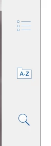

    BELOW:  Correctly displays with expanded browser. This is the same for original and newly generated (same project)
    BELOW:  Correctly displays with minimized browser (original)

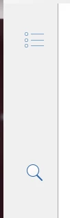

    BELOW: Missing with minimized browser (same size FYI) with newly generated (same project).  The index icon magically appears when expanded.
    BELOW:  Note, the functionality is there!  If you click on the space where the index icon should be, the index displays.
