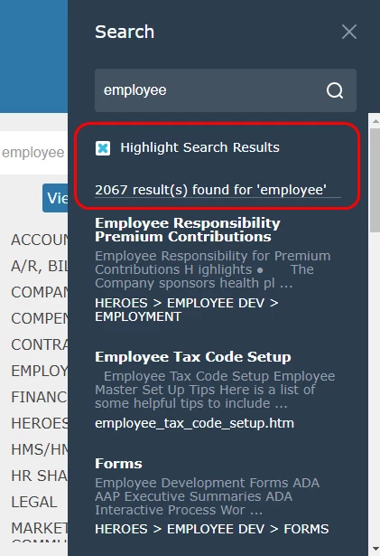

Indigo layout missing - include all words in search - option
Using Indigo layout with merged project using RH 2017 and just downloaded newest Indigo layout in hopes of fixing search not finding results consistently in Chrome and Edge. I thought maybe it was because the New Indigo layout is not displaying the "Include all words in search" option. Any idea of what I am doing wrong?

I just noticed that I had an additional customization of changing the label of "Index" to "View Index" in the project. Does this affect anything? When I applied the updated Indigo layout to the an existing project, the buttons are back. I first see the default labels flash (Index, Glossary, Favorites) and then the updated label "View Index" replaces it and remains with Glossary & Favorites.
Also, the search is not working. The gray boxes are swirling but no results. Do I need to publish all the merged projects before the Search will work?

You must generate all projects in an HTML5 output before the merge will
work properly.
