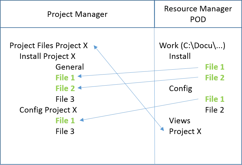

What I want to know exactly is the following:
I have several "general" projects like "Install", "Configuration", "Views". Then I use some topics from each of these projects in other projects (via the Resource Manager; the topics are linked and keep updated). In the combined projects, I see which topics origin from somewhere else (this is indicated by a green check mark). I can even see, where this topic origins from via the file properties - path.
I'm looking for an option to see in the source project, if a topic is used somewhere else and if yes, where. This would be very helpful, if I need to rework such a file or just want to delete is.

    Hi Rick,
    Yes, the topics are in the Resource Manager Pod. They are also stored in a more or less common location (C:\Documentation\Work\Project[xyz])
    I drafted how it looks like
    In "Project X", I can see which topics are taken from another project and from which one. I'm looking for the information in "Install", that "File 1" is also used in "Project X".

    Peter Grainge
    Jan 19, 2017 11:14 AM UTC
    Can I clarify that Install Project X is a different project to Config Project X as both are shown under Project Manager which would be separate for each project?
