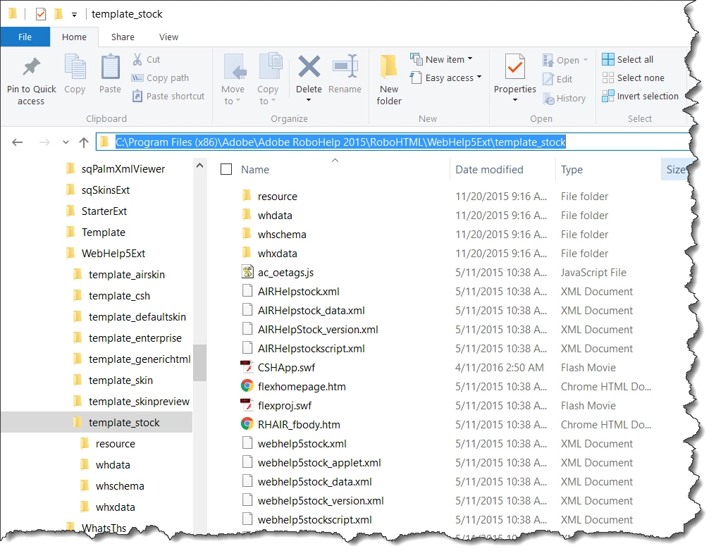

Hi there
There is a group of what I call "seed" files that are installed. I'm unsure of the exact file you need, but you might investigate the files inside this folder location. For me, the easiest way to get there is to right-click the shortcut that you use to start RoboHelp. From there you should be able to either click a button or copy the install folder location for easy reference.
So you could modify the seed file in this location and it might provide what you need.
I'd certainly make sure to save a backup for our friend Justin.
Cheers... Rick
