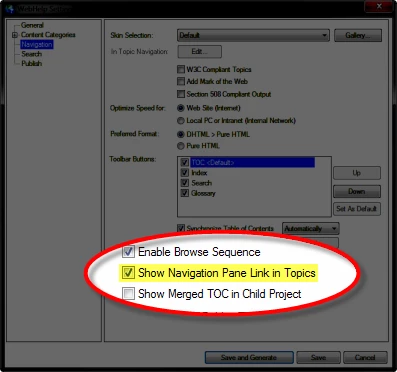

Hi John
Here's the deal. With RoboHelp, you create HTML topic pages. And when it's time to create output, you choose the output type and create it. From what I've seen of your code, I'm guessing that you created WebHelp output. In WebHelp output, as the WebHelp is generated each topic is copied from the hard drive into memory and modified. Exactly HOW the topics are modified depends on the options you have selected in the Single Source Layout (SSL) recipe. The options govern which different bits of JavaScript code are added and inserted into the topic. The modified version of the topic is then saved to the folder location specified in the SSL recipe.
One of the options is called "Show Navigation Pane Link in Topics".
With this option enabled, the JavaScript code written into the topic performs a "sniff test" to ask: "Am I being presented within my WebHelp frameset?" and if the answer is no, code is written into the topic that provides the end user a link that reloads the topic within the WebHelp frameset when the user clicks it.
I do know that a year or two back, some sort of "cross site scripting vulnerability" was discovered, but I believe Adobe issued a patch shortly after the discovery that addressed it.
My guess here is that while it may look bad, what you are seeing is pretty innocuous and nothing to be concerned about.
Cheers... Rick
