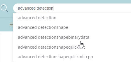

I'm using RH 2020.8.34 Frameless output, and when I use Search, no results are displayed. It shows terms that match my search term, but when I hit Enter, nothing happens.
Any ideas?

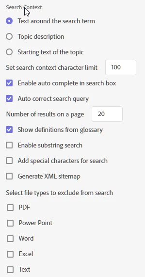

    For the fun of it, I enabled Layout > Use skin home page in a "test" frameless output preset, and search works from that. That led me to wonder if I could have messed up the functionality of search with skin edits, so I went back to an older skin, disabled Use skin home page, and regenerated. It seems my skin customizations may have broken Search... 😛 I'll troubleshoot and repost here if I can't fix it, but I'm thinking it's "user configuration error."

    I haven't found the reason my first set of customizations broke search, but when I started over with customizations, search is still working.
