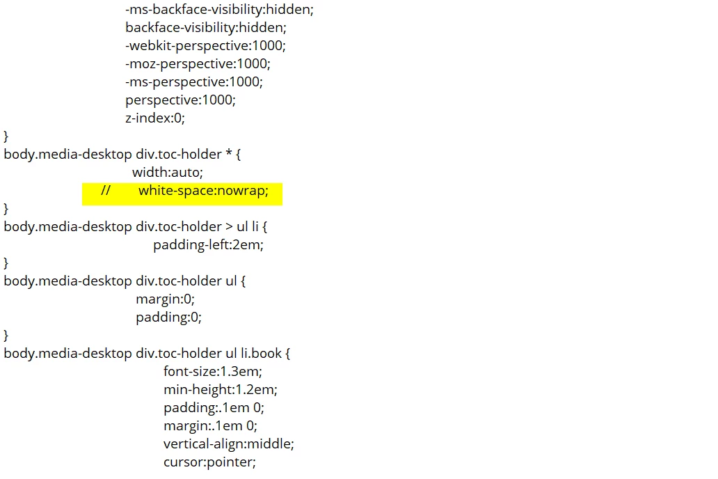

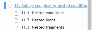

Is there a way to make Robohelp 2017 word wrap long titles in the TOC of responsive html 5 output?
Long titles are not shown correctly in my output, and I have to expand the TOC column to be able to read to full title.
gc31Correct answer
Jul 9, 2018 9:46 AM UTC
open the layout.css in Notepad. This is in the !ScreenLayout! and then Azure_Blue folder (or whatever layout you are using). You are looking for the following highlighted in the image below.
Comment the line out with // as shown below and regenerate help:

Okay, for Responsive using Azure Blue or Charcoal Grey, to make this survive generating, you need to add a custom css file. Paste the following into the custom css file:
body.media-desktop div.toc-holder * {
	white-space: normal;
Then add the custom css file to your skin in Layout > User Assets.

Thanks a lot! It worked.
