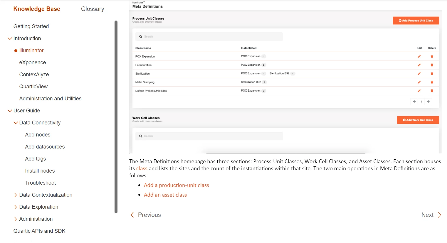

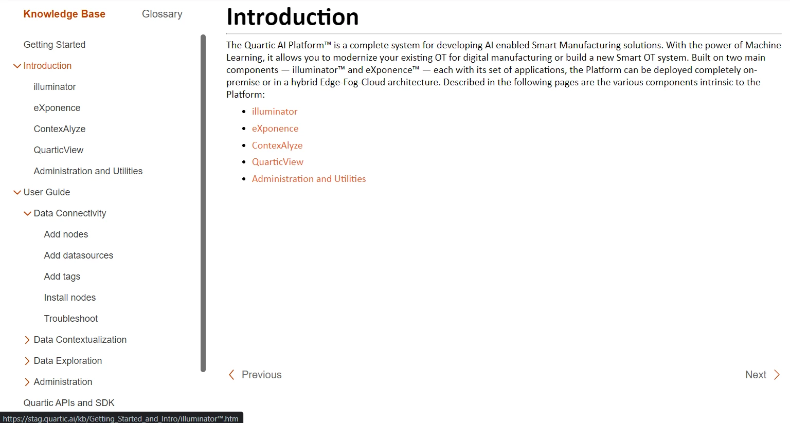

For Prev and next button in my Frameless output, I used browse sequences and added all the required sections and topics in the order. When the Frameless output was deployed for production, I found Prev and next button is working only for sections, but Prev and Next button aren't working for topics under the section. In the below-attached pics, the first picture's button works, and the second picture's buttons doesn't work. In Robohelp's local output buttons were working fine but as we deployed the output, we are facing this issue. I request to help me with this issue. Thanks in advance.

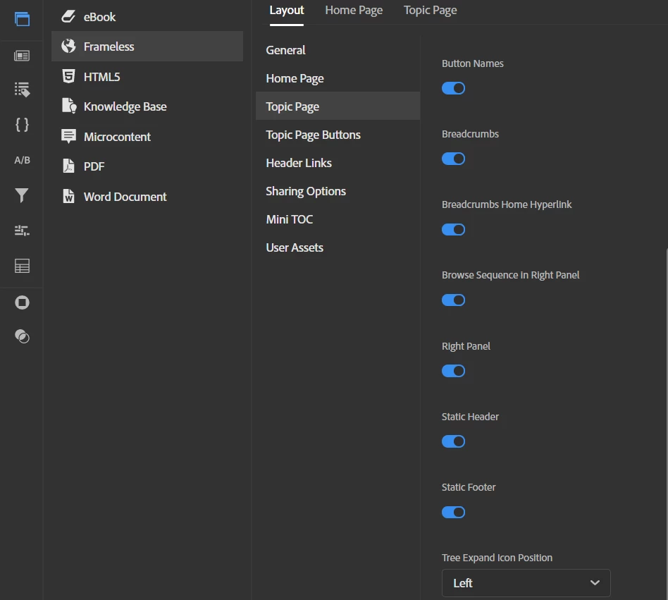

    Sep 8, 2022 10:59 AM UTC
    Can you post the solution for anyone in future who has the same problem?
    I have turned on the toggle switch of "Browse sequence in the right panel". After turning on these navigation buttons "Prev and Next" works perfectly.
