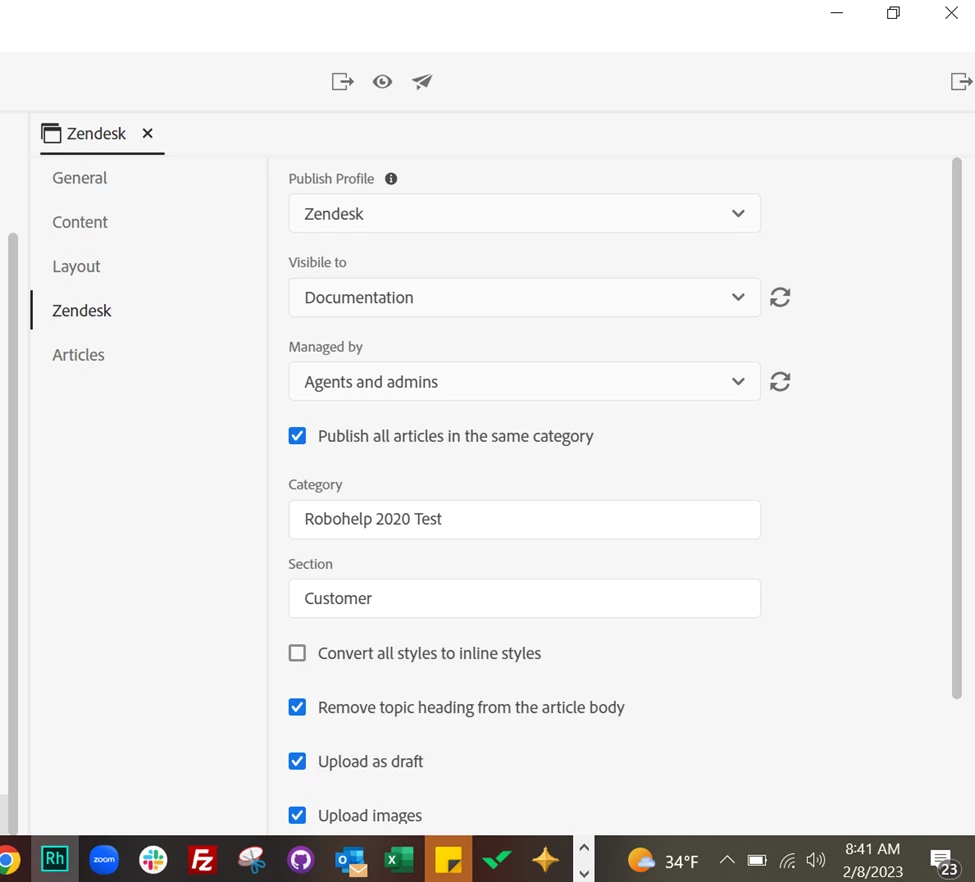

Issue Publishing to Zendesk Using Robohelp 2020
I'm having issues getting my Robohelp 2020 project to publish to Zendesk. My publish profile has Zendesk Help Center as the Server Type. I can see the appropriate selections when I use the dropdown for  "Visible TO" and "Managed By" (So the user name and connection to Zendesk is correct)  I have my articles selected that I want to publish but, I continue to get this:
What am I missing?

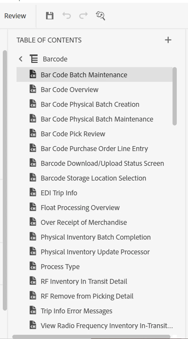

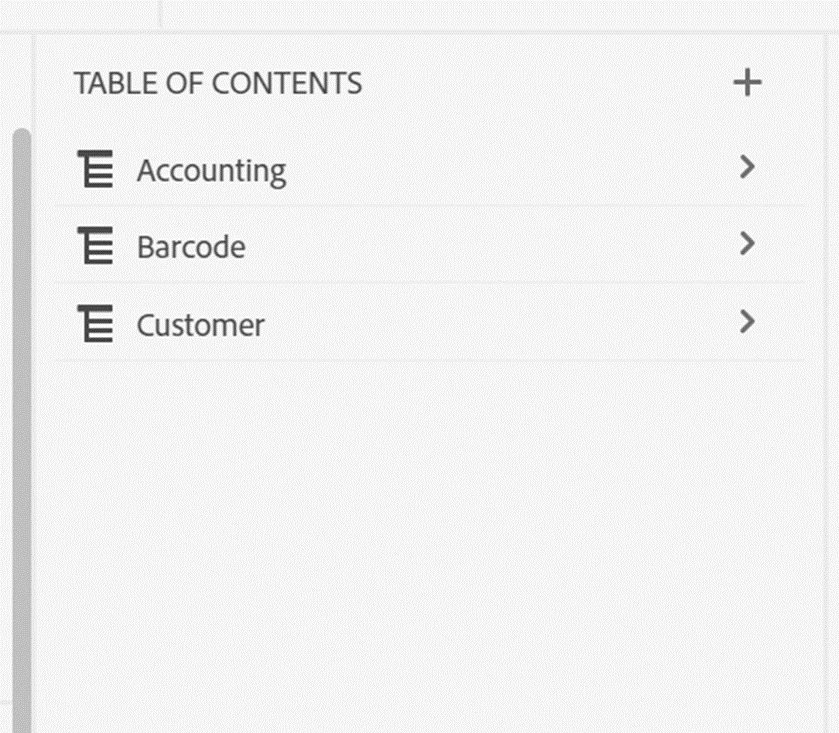

    Feb 9, 2023 10:55 PM UTC
    You have 3 different TOC files, and the one you posted a screenshot of doesn't include any sections, only topics.
    Try adding two sections to the Barcode TOC matching your Zendesk category (I don't know what this is) and section (Barcode) and nesting your topics under that.

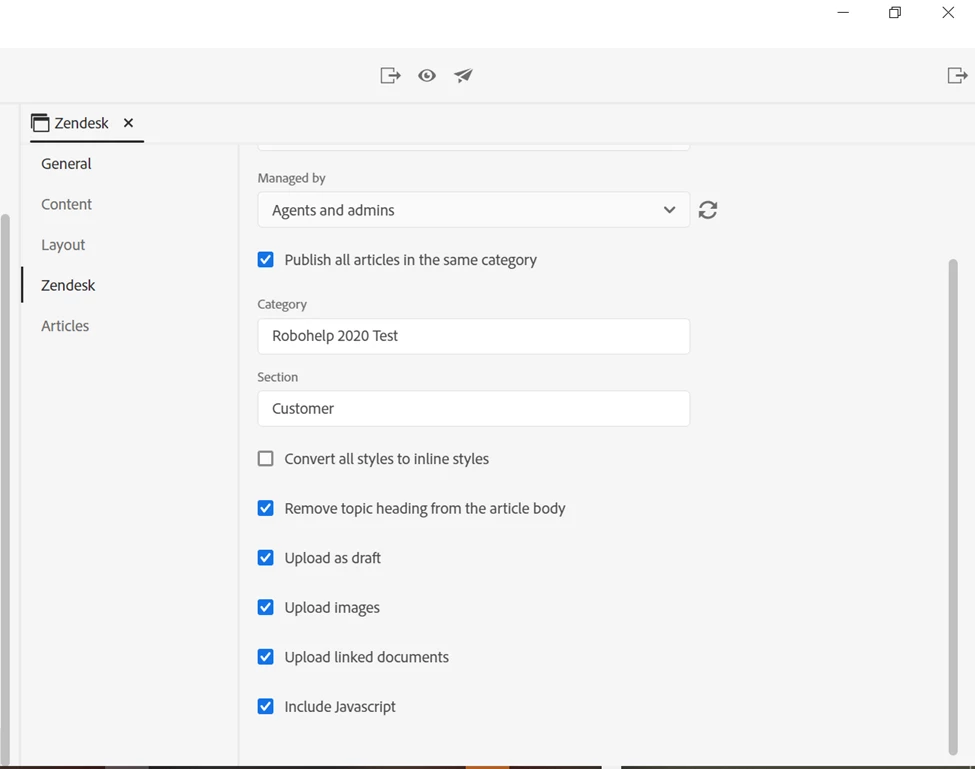

    Feb 8, 2023 10:58 PM UTC
    What are the categories and sections in your zendesk help centre? I believe you need to match those in your toc.

    SNB123Author
    Feb 9, 2023 2:10 PM UTC
    Yes our category and section were specified and our TOC was based off the section. (I.E. Accounting TOC for Accounting section in Zendesk. )

    SNB123Author
    Feb 8, 2023 2:06 PM UTC
    So here are a few examples of the setups I have in our project. A little backstory, we had 32 separate projects that I combined into one project. Rather than one TOC (which I noticed didnt work) I tried to create a separate TOC for each project. There are a bunch of articles in each section, so Ive tried to publish all (didnt work) and then I tried selecting a few. Some have published to Zendesk while some have published empty.
