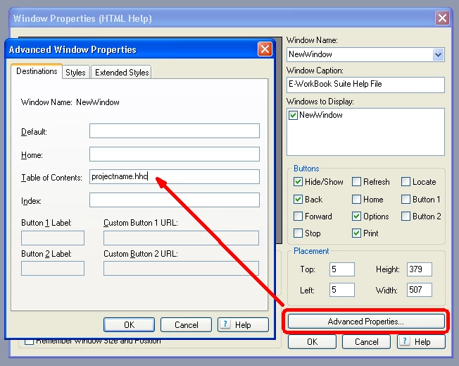

    Hi Vikas and welcome to the RH forums.
    The secret here is to add the master project's TOC file (projectname.hhc) to the Advanced Properties inside the window being used by the SSL you are using inside your child projects (see below). You'll also need to add the .HHC file to the baggage files in each project.
