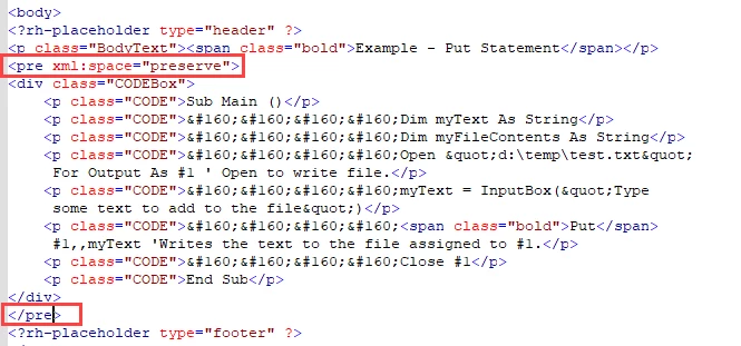

After some testing it was found that by using the pre tags such as in the snippet of code below, the language translation software is able to process the lines of code without stripping out the whitespace.
One issue I'm facing is when I apply the <pre> tags over the entire code snippet which, in this case, are contained within <div> tags:

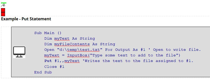

It looks fine in the RoboHelp Design view:

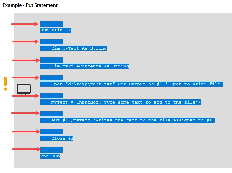

But in RoboHelp Preview view (Ctrl+W) or when I publish the topic, RH for some reason inserts a blank line after each line in the code. Here's what it looks like after I drag my mouse over the lines of code in the browser to show the blank lines:

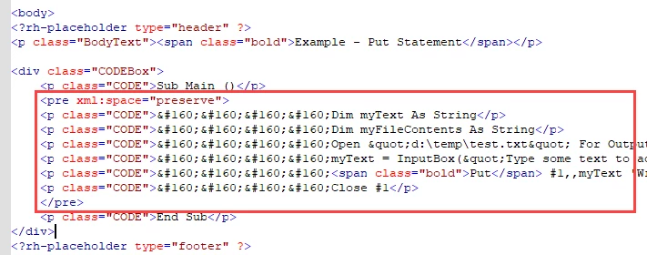

If I apply the <pre> tags just over the lines of code that have the whitespace I need to preserve:
In Design view, when I select the lines of code, you can see that RoboHelp has added lines of whitespace after each line of code for some reason which also show up in Preview view as well as when I publish the topic:
