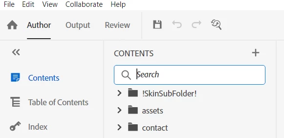

Issues with Contents search for topics with latest Robohelp 2020.4.273
Yesterday, I upgraded my Robohelp 2020.0.1 (upgraded to 2020.0 from RH11 back in October 2020) to the latest version 2020.4.173. I am having trouble with searching the Contents for my topics. It is taking a very log time and not returning my topic even when I put in the full name of the topic.
I see now that you have enhanced the search to display other types of files however this is not working for me. My project is large and I want to know if there is a setting that I can use to search for topics only.
Thank you.
Beatrice

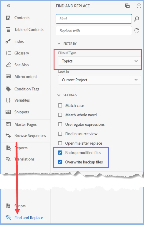

    Peter Grainge
    Apr 28, 2021 4:08 PM UTC
    So you are talking about Find and Replace rather than Search, correct? If not, then please clarify.
    Set the Filter By to Topics. If you are going to use Replace, note the two setting highlighted blue. Your choice, I'm just pointing out extra files will be created.

    beatab1962
    Apr 28, 2021 4:17 PM UTC
    Hi Peter,
    First of all, many Thanks for all your extremely helpful information!!
    I am talking about entering the name of the topic that I want to work with in the Author - Contents- Search box below.
    For some reason, it is taking a very long time and the search results do not return the topic that I am looking for even though I ca find it my other means.
    Thank you.
    Beatrice
