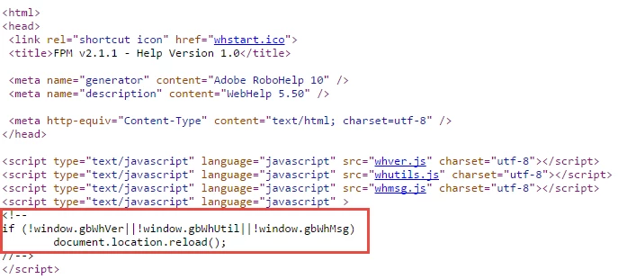

I am using RH10 and webhelp generated outputs work correctly locally and when on servers. I am trying to add webhelp to SharePoint and there appears to be an issue.
The SP developer says its this part of the code that may be causing problems.
If I remove the code the page opens but without any images, style sheet applied etc.
Any ideas?

Are you all patched up with the latest browser fixes for RH10? Does the help appear correctly if you look at it on a local or LAN drive? If so, then I would suspect it’s some setting in SP that’s messing you up.

How are you serving the content on SharePoint? If you create a document library that shows all .htm as regular website, it normally works. What is your configuration?
