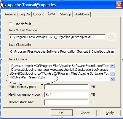

You need to increase PermSpace available to your tomcat. You can do that using <tomcat-install-dir>/bin/tomcat6w.exe
Just ensure that your “Maximum memory pool” and “XX:MaxPermSize” should not add up to more than actual memory you can make available to tomcat. The setting is as shown in this snapshot:
September 1, 2009
Thanks Tulika!
We implemented the change on our server the other day and so far it seems to be running well! No blow ups thus far. I'm crossing my fingers that it's never going to have troubles again.
