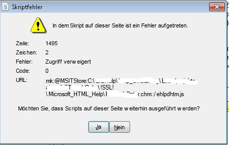

javascript ehlpdhtm.js could not be executed
In a page I have the following HTML:
<?rh-s
<?rh-script_start ?><script src="../../ehlpdhtm.js" type="text/javascript"
                             language="JavaScript1.2"></script><?rh-script_end ?>
cript_sta
rt ?><script src="../../ehlpdhtm.js" type="text/javascript"                             language="JavaScript1.2"></script><?rh-script_end ?>
And later:
<span
l <span
     style="color: #3366FF;"><a href="javascript:BSSCPopup('../../../../SomeDir/OtherDir/YetAnotherDir/Konfiguration.htm');"
                                 id="a1">Konfiguration</a></span>
When I test the chm and click on the link,I'm getting a javascript error, saying:
I assume, that the path is wrong. How can I add this external .htm to my project such that it is compiled into the .chm?
Otherwise I would have to carry around a bunch of external .htm files with my final chm.

See if Item 6 at http://grainge.org/pages/snippets/snippets.htm#chms helps.

I'm not sure if it's just some sort of typographical error, but your post has this:
If this isn't a typo, try removing the part I highlighted.

Thanks, Rick, it was indeed a typo in my post (due to pasting into a code section).
