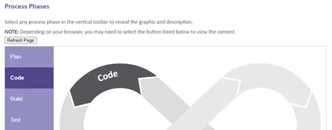

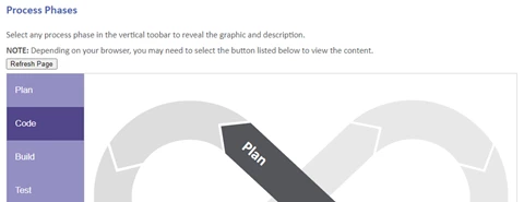

RoboHelp 2020.5.71 is the authoring tool. The JavaScript code was moved to multiple locations (external file, within the header, within the body) to determine if that was the issue, but the results are the same.  As you can see by the screen shot, I added a refresh button to the topic so the users can select it to activate the script, but this is just a band-aid.
In the example above: select the Code menu on the left and the script does not run.
In the example above, refresh the page, then select the Code menu, and the script runs.
