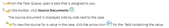

I am attempting to create ordered lists where occaionally an item will contain an in-line image. When I add the image, the line of text automatically moves down to accomodate the space, leaving the number in its usual position.
In the screenshot, item 1 is inline with its number, item 2 is slightly off, and item 3 is way off. I've attempted adjusting different settings without any success. To make things more confusing, I also need this this function correctly in multilevel, mixed lists where bullets are used for the second and third tiers.

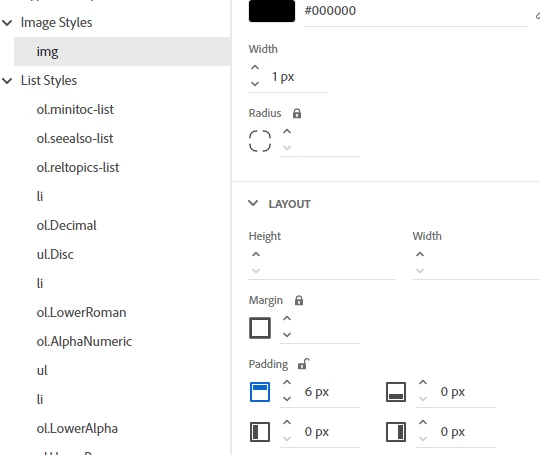

    I have been struggling with this same issue. An inline image causes the number part of the list to "float." I've been all through my list style, but finally found the solution in my image style. I had set a 6 px padding (it's blue in the picture below) to keep my regular images from smooshing up against the preceding line of text and to try to keep that spacing consistent. But I had not made a separate image style for my inline images. When I removed the padding from my img style, the numbers lined up with the text baseline again.

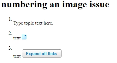

    I think it's to do with a p tag somewhere being set to "display: inline-block;", in combination with "vertical-align: top;". (The differing heights are to do with the size of the images.)
    Note: I can't comment on multilevel numbering as I don't use it. I recommend making changes in a small test project with a copy of your stylesheet so you can revert to the current settings when necessary.
    For example I get this with the following stylesheet:
    li {
    p {
    	margin-top: 10pt;
    img {
      (yep, that's the entire stylesheet)
    And this is the html:
    <h1>numbering an image issue</h1>
    <ol style="list-style: decimal;">
    	<li><p>Type topic text here.</p></li>
    	<li><p>text <img src="../Images/Buttons_Icon.png" alt="" style="border: none;"
    					 border="0" /></p></li>
    	<li><p>text <img src="../Images/ExpandAllLinks.png" alt="" style="border: none;"
    </ol>
