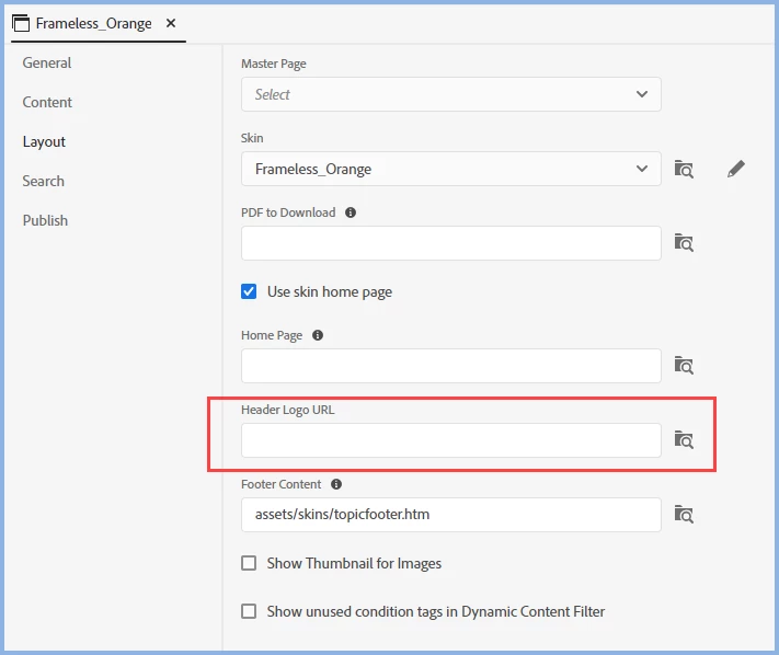

It has also just occurred to me to ask if you have defined the URL for the logo. However, if that is it, I am wondering why it works locally.
