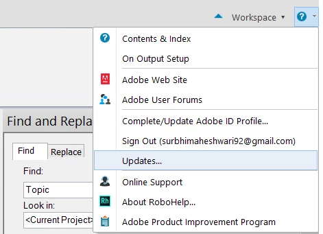

    RoboHelp 2015 is Windows 10 certified after application of patch 1.
    We have also released patch 2. You can apply the latest by Help drop down at the upper right corner> Updates as shown in image below:
    This will show you the latest release available and you can then apply it.
    Let us know if you face any issue even after applying the patch. We are right here to help you out.
