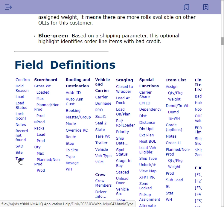

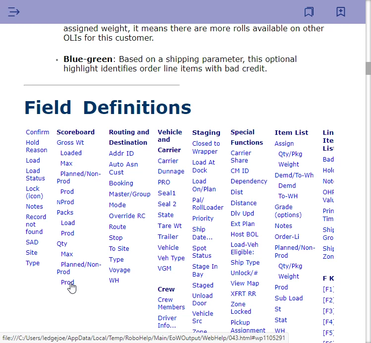

The link shown at the bottom of this window is NOT correct. It's trying to use the path on my hard drive.
The link shown at the bottom here is correct.

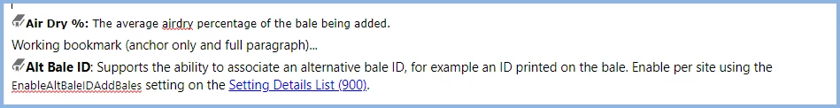

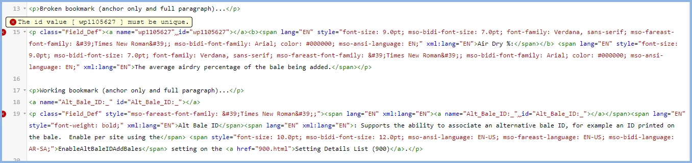

    What I did was paste into a topic what you have posted. Straightaway it shows two errors so if you are seeing any of those, that needs fixing. In this case I simply deleted lines 15 and 19.
    With that done the author view showed this.
    Next I created two links to those bookmarks and both worked.
    If you switch to Source View, are you seeing any red circles indicating errors?
    Nope, there aren't any errors.
