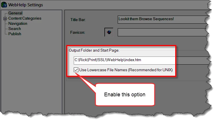

    If this is WebHelp, try looking at your Single Source Layout properties. Once there, enable the option named "Use Lowercase File Names (Recommended for UNIX). Re-generate the output and copy the updated files to your server.
    See if that changes things.
