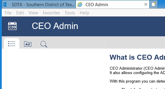

I just upgraded to robohelp 2020 and having major problems with the product not displaying my help correctly. The upgrade went smoothly, and when I first display the output the TOC displays. However, the index and search does not work. When I go back to the TOC after going to the index, now the TOC no longer displays. Any ideas?  Could this be an IE problem? IE is the default browser here so it has to work for IE.

    I had trouble when I first included the image in my post and the post didn't go through. so i first sent the text and then the picture.  But to answer your question, I have the exact same version of IE as you. I sent the picture because I don't remember the name of the skin because I changed the name to the product name.
    Aug 12, 2020 5:37 PM UTC
    Just a note. When the help first displays, the TOC does have information. However, if you go to the index and back to the TOC then there is no information in the TOC. So the picture was taken after I went to the index and back to the TOC.

    Ok my post didn't seem to go through so I will try again. I have the same version number. I don't remember the name of the skin I used because it has been quite some time since I picked the skin. However, I included a picture. I will post the text and then the picture
