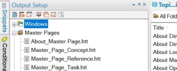

    Thank you for your help.  I found the Master Pages in the Output Setup pod.  And the Help now matches since I upgraded.

    Jul 6, 2020 4:18 PM UTC
    Yes it is correct. I think master pages may have been in Project Files going back and then moved. I suspect this project goes back to when that was the case and the folder in Project Files got left behind.

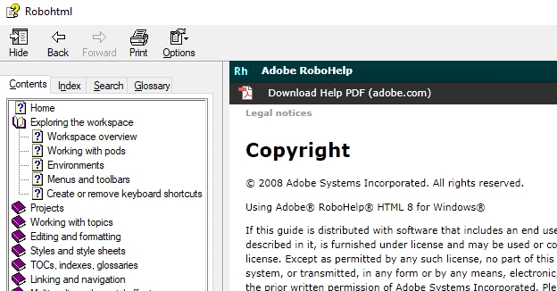

    I see the chm file for RH 8 Help as well.
    Thanks, I found the Master Pages listed under Output Set up.  Shouldn't you also see them in Project Files in Project Manager Pod?  The Master-Pages folder is empty there.

    Maybe they fixed the help with Update 13 or 14, which I don't have yet. Mine is definitely for something pre-ribbon and the legal notices list RH8. 🙂

    Jul 2, 2020 7:26 AM UTC
    I'm seeing the correct help.
    The UI can be configured in many ways but you should find Master Pages in the Output Setup pod.
    Jul 2, 2020 12:13 AM UTC
    Yes, the chm file distributed with RH2019 Classic seems to be the help for RH8.
    Try the link for RH2017, which should be mostly correct:

    For the master page, try looking in the Output Setup pod for a Master Pages folder and see if it shows up there.
