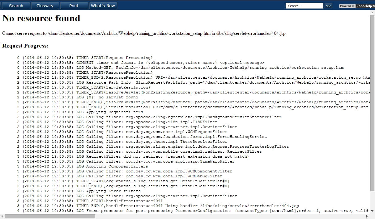

PeterGrainge Realized that this post should be classified under WebHelp, so I will just add this post to the WebHelp site. If we did go the chm route, they would only need to download it once - not every time to view it. That route was easy enough, though not our #1 choice with the issues you mention. What I meant about partitioning us a server, it was assuming (with the knowledge I have so far) that CQ5 could not house WebHelp itself and we would have to link to a server that WebHelp would sit on. We have other clients that will be able to access the help directly from the program (those are our hosted clients that access the program from one of our servers), but developers won't allow me to link from that server to CQ5, so our locally-installed clients need to be able to access the help elsewhere. Hence, we were thinking they could house the help on CQ5 and have locally-installed clients access it from CQ5 - our extranet. Which brings me to my current issue. I was able to upload the WebHelp contents just fine and the help opens up beautifully to the start page, HOWEVER, when clicking on every other topic, we get this on our pages:
All the files and folders are present in the DAM (Digital Assets Manager in CQ5). Is it the way CQ5 reads the help the reason we're getting this error? Can you think of a workaround/solution to this?

That has to be either the upload or the environment, assuming the local version is working OK.
Users only have to download once if they remember where they stored it. Can't the developers install it to avoid the problem?
Sorry but CQ5 is not something I am familiar with so I cannot help on that front.

Thanks for your help, Peter - I appreciate it. Developers could possibly install it, however, the help will be updated on average every 6 weeks, so that's where the problem lies with our locally-installed clients. We're having a call with the CQ5 developers today, so hopefully we can come up with a viable solution.

I have no working knowledge of CQ5 but it appears to be for managing web content. I am not understanding why that cannot include webhelp. WebHelp is rather like a mini website so all your main content needs is a link to it. I am also not seeing why the server would need to be partitioned. All you need is a dedicated folder.
It seems odd that a company such as yours and using something like CQ5 cannot find a way to make WebHelp available. Maybe IT need a bit more prodding?
