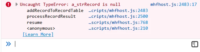

This was the same problem I was having, I think. I'm ended up getting the same issue in our Swedish version of our Help yesterday. It worked fine locally but never finished searching on the webserver. When I checked the console in my browser as it's hung, I saw this "Uncaught TypeError: a_strRecord is null" message:
And it reminded me of your post earlier on this thread. I then installed the updated script from bug RH-7437 and rebuilt all the helps (child and parent) for Swedish, and this morning it appears to be fixed. I did do a Beyond Compare first and saw that it only differed in that one line where they changed if ( a_strRecord == "" ) to if  ( !a_strRecord ).
