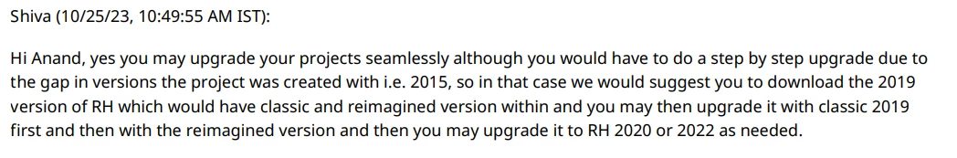

    Thank you, @Peter Grainge, for your reply. To answer your question, I randomly went through your website and didn't look into this specific URL: https://www.grainge.org/pages/authoring/rh_tour/rh2022/introduction/upgrading.htm. So, I consulted Adobe support and had a chat, and this is what they told me exactly:
    To answer your next question, we are running out of time, and it will be good if we keep our existing CHM version working and work on other new features that the tool provides later or try some other output format.
