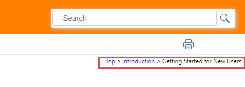

I'm having problems with formatting with breadcrumbs. I would like the formatting to be synonymous to the picture that you included above where the subtopic page I am on is in black text and the parent page of that subtopic is in blue text. This way the user knows that the parent page is a link that they can visit.

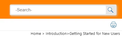

    Hi @Jeff_Coatsworth,
    Thanks for your response! I'm using Adobe RoboHelp Version 2020.8.34. I'm creating a Responsive HTML5 output.
    For reference, below is the breadcrumbs output that I currently see:
    Below is the output format that I would like to see:
