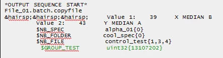

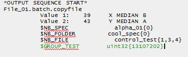

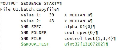

To be more specific: I have several code lines that display wonderful in FrameMaker 10 when set in a monospace font, such as Courier New or Lucida Console, as you can see below:
However, as soon as I import them in RoboHelp 9.0.1.262, it looks like the the fixed character width miraculously vanishes and no matter what other monospace font I use, the result is pretty much the same, i.e. the lines (and "faux columns") are no longer aligned:

Moreover, when I try to tweak the space amount by replacing the regular blank "&#160" with (fixed) en-dash spaces " " or hairspaces " " in the HTML source, as shown below
it looks like RH is not able to recognize the codes:

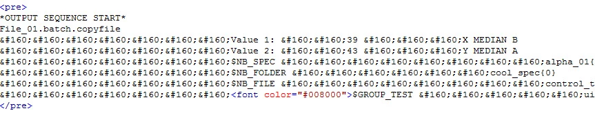

1. In RH HTML View, I've manually put the code within <pre>... </pre> tags (the blanks are also magically 'normalized'):
2. In the same RH HTML I've "colorized" the line I've needed highlighted by using <font colour=...>, as my character tag is overwritten by the <pre> tags:

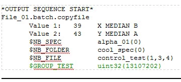

The HTML result is this beautifully aligned and highlighted code sample, which, by the way, displays properly in RH Design View too (see the screenshot below). By the way, I have a hunch that this will also nicely publish in PDF
