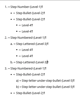

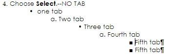

I'll start with I have already gone through Peter Grainge's site and watched the recording on multi-level lists. It was all VERY helpful, but I am still struggling a little. We are upgrading multiple projects from Classic to RH 2020. We had paragraph styles and multi-list in the old style and of course some of that is not coming over. I have set up the levels with the new Multi-list style but it indents far more than we wanted. It looks like it's  not indented in the .css view, but it is in the preview of the output. I've selected the indent buttons but it doesn't change. Here it is in the template view...

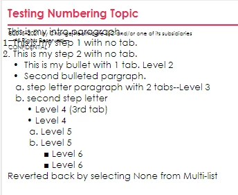

Here it is in the preview of  topic with that template and ol paragraph tag (I put Tab text in to show that I used tabs to get the level I wanted):

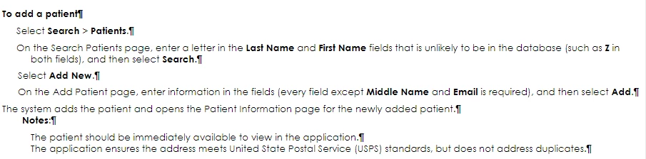

Examples of what I am trying to recreate (of course it doesn't exactly match the above, but I wanted to show you how/why we'd use these levels):
Thanks for any help you can give.

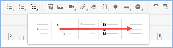

Select all the contents of a single list, then click this icon. Is that what you are doing?
Then with anything that is indented, click this icon.
At that point your content should just have P tags applied. Check it in source code.
Then select all the contents of what should be in a single list and apply your list style from the Styles panel.

You can't remove the P tag in one go so you first go to the list toolbar and select any of the list icons. They each have a None option, select that. Then apply the cleaned up list style. What you should see is the new list style and in code view just li tags and no P tags.

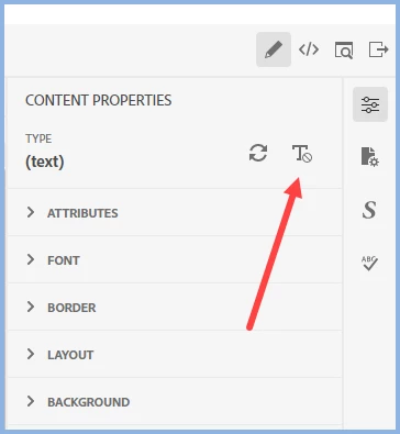

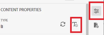

Select the text with those indents and go to Content Properties. Click the Clear Formatting icon.

Yeah, I did what you said before I posted this request and it didn't take away the P tag. Trying it on another old topic and I have to apply the None option from the list AND the None option from Styles to just get rid of the numbering. I should warn you that parts of this project have been continually updated and added to since the predecessor to RoboHelp... (WinHelp? I've forgotten what it was. Anyway, it's gone through every version of RH).
If we had the time, we should probably just strip it of everything and start over, but we are already behind on everything.
Ok, here's another topic that I selected None from the list icon and then selected None from the Styles to get rid of the numbering because selecting None from lists didn't get it all (I also have to be careful what I send... had to alter text to remove some company info)
Here it is in Author view after removing the list and paragraph tags (supposedly) but before adding the new style.
Here is the HTML view of that
And I'm not sure what you meant at the end about Clear Formatting icon
Thanks again! Sorry I'm either not getting it or it's just not cooperating.

AH I FOUND IT! sorry. I should really wait to reply on those others. Clearing the formatting with the Content Properties fixed it all! Thank you! I just didn't know where that was. I havne't had time to do as much training and just needed to figure out the numbering. I'm still very new to this new version. For anyone else as new as I am to this version, it's that you select the Content Properties icon and the Clear Formatting icon
