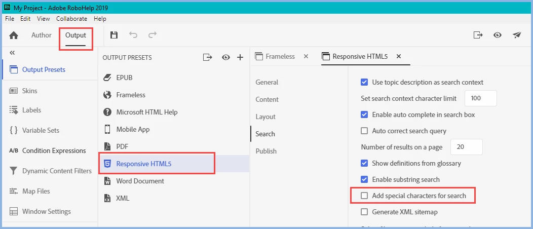

    Are you looking in 2019 New UI? Top left when you open it there is an Output tab. In the Frameless and Responsive presets, it is in the search options.
    Select the option shown and the characters will appear.
    It hasn't been added to Classic, as I suspected and I doubt it will be.

    With %Peter% in a topic and this change in the Search settings, %Peter% was found when I added ;% to the end of the supplied list.

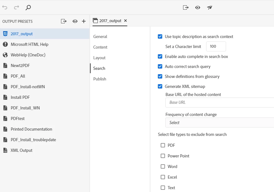

    In the 2019 new layout, I don't see a new text field and checkbox added or list to manage:

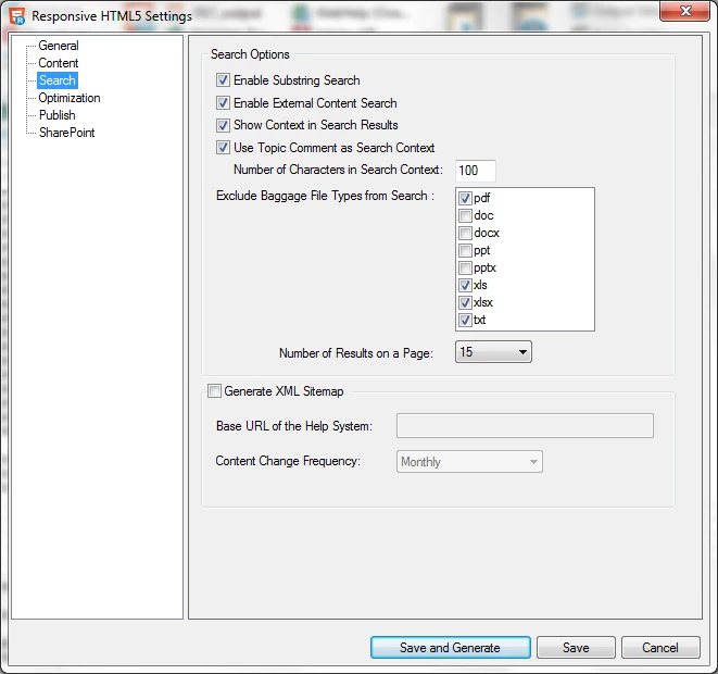

    In the Classic, same thing:
