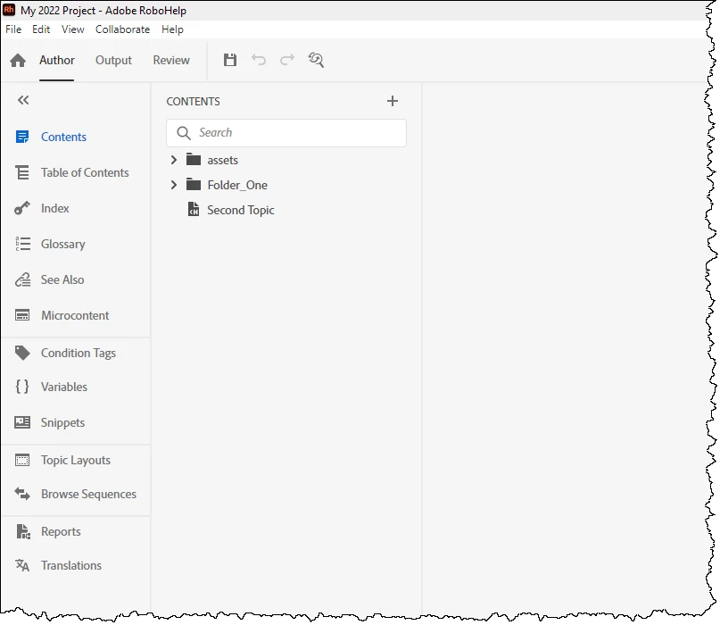

    When you open the project does it look something like this...

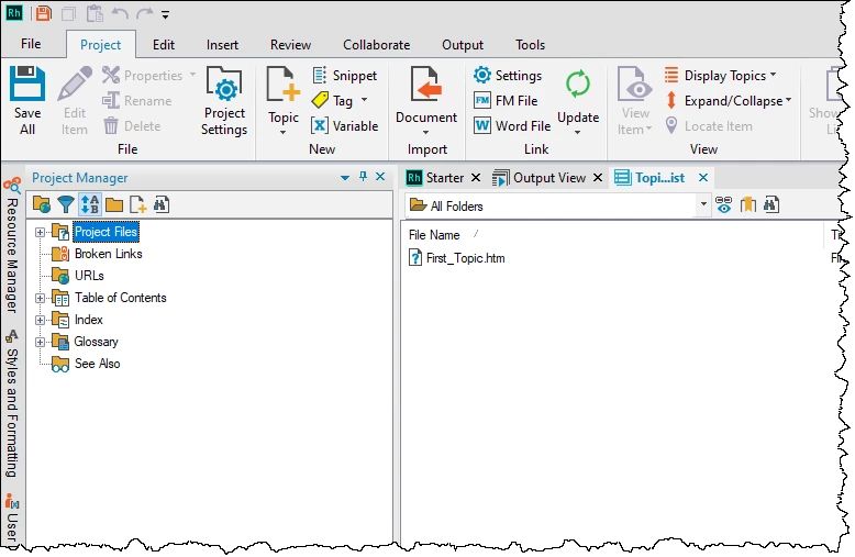

    or like this?

    goLobosAuthor
    Dec 16, 2022 8:52 PM UTC
    definitely the one at the top
