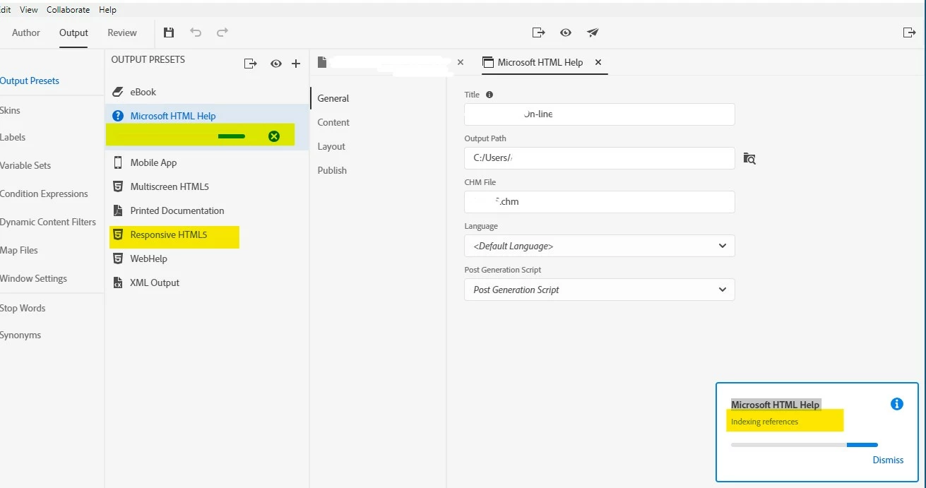

d.  Next I went back to the first file at step a. ( noting that the file is large) to attempt to convert it to Microsoft HTML Help, with a view of replacing the same converted file in my VMware to see the application opens it up as it does for a .hlp file.
e.The conversion started off well and looked promising with the pop up lower right notification bar moving fine and the file names changing, it has got to the 'indexing reference' and it appears to be stuck.  the small 'i' button does nothing. I've looked for logs to see if I can find any errors, hangs in the process but nothing.

I'm afraid I don't have any steps that will definitely help. Even trying to get .hlp files to run has been a problem.
In the testing I've managed, I've only got the text to import, no table of contents, index or stylesheets.
So my theory is that you only see a couple of things in your output because you don't actually have a table of contents. New UI requires all content to either be in the TOC or linked from a topic in the TOC. The build, I theorise, is only including the default topic and a few topics linked to the default topic.
There's a chance that some of the code from the import is also causing problems. I had a lot of weird characters and formatting code displaying in the sample .hlp file I managed to convert.
So I would start by making sure your topics are in the table of contents.
Also make sure you select a skin in the Output Preset. Sometimes the output generates fine without one and sometimes it fails, no idea why.
And check that the start page is set. This is usually index.htm (DO NOT give this the same name as a topic in the project.) And that there is a Default Topic - select the relevant topic from your project - often it's Welcome or Getting Started, but can be any topic in your project.
Then try generating to see if you can at least get the content in the output for your point b). Post back with how you go.
I don't think the old winhelp see also and related topics controls transfer correctly, and I also had all sorts of weird formatting and characters in the topics. So I think you'll need to do a lot of cleanup once we get the project generating.

Oct 8, 2020 8:56 AM UTC
Hopefully Amber will have some notes that help with the conversion from the HLP format.
I note you are using VMWare. Is RoboHelp running in a Windows 10 environment within that? It will not run properly in the server environment.
Are all the topics you expect to see in the TOC. That's a major change in the new UI versions. It doesn't mean the user has to see them. You add all topics but select the hide option in those you don't want the user to see in the TOC. Take a look at the link below if that could be the issue.
https://www.grainge.org/pages/authoring/rh_tour/rh2020/toc_index_glossary/toc.htm
You also need to be aware that CHMs will no longer work on a server. It's only been a problem since 2004. 🙂
Given the changes you have to make anyway, I would suggest you try creating a frameless output as going forward that is where Adobe will be focussing their development. You can still use CHMs installed on local machines but they are now dated.
It will be well worth the effort to find the source project as that will hands down beat any reverse engineering.
Prior to XPJ being the file to open projects it is the MPJ file. Search across your network for those file types.
