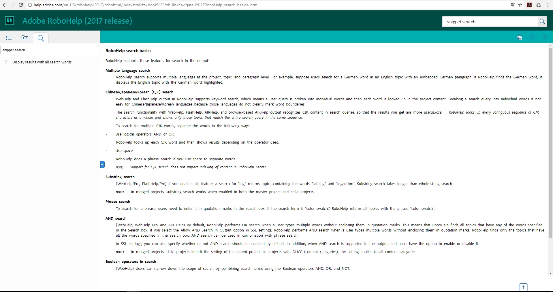

On a second reading, I guess you're right. That's a pity .
However, isn't the RoboHelp 2017 help itself also a responsive HTML5 output? And they have the checkbox "Display results with all search words" in their help output (see screenshot below, taken just now). So how did they get this checkbox then? Or is the RoboHelp online help a different kind of output?

It's probably a home-rolled solution, but you could try playing with other SSL layouts to see if different ones offer the AND search feature you're looking for (I haven't got a copy of RH2017 at hand to check).
