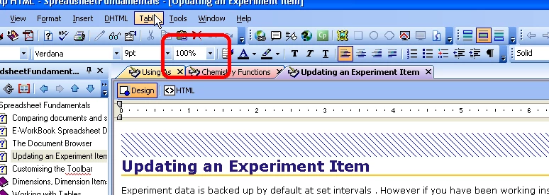

Hi and good evening
Is your zoom perhaps set to a value larger than 100%?
Greet,
Willam

Hi bvconway. There's actually a problem with zooming in Robohelp, where when you zoom in, the "page" expands off the viewable area and you have to use the horizontal scroll bar to view the enlarged text. This is what these people you are replying to had the problem with, not with space character entities.

Jun 9, 2010 2:39 PM UTC
What is your WYSIWYG zoom level set at?

Hi Colum, that was it.
I had my zoom set to over 100%.
Thank you so much!!!!!!!!!!

Hi and good evening
Greet,
Willam

THANK YOU!! That was it!
I guess I need to invest in some stronger eyeglasses....instead of zooming in! LOL
