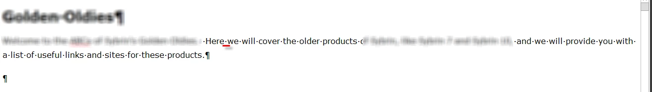

So one of the issues I have with this project, currently upgraded to the latest RH2019 version, and on the new layout, is that RH would place random <span> tags in places in the HTML code.  I believe this is due to changes between then and now, in how the software handles and generates code from the text side, as it's not an issue on newer projects I'm working on.  Anyway, those random tags often create extra spaces between words, icons and other elements on the page.
In the earlier versions of RH (I checked and see it's still on RH2017) there was an option to see spaces and paragraph markers (formatting marks).  Paragraphs (line breaks) are indicated by the pilcrow mark (¶), and spaces are indicated by an interpunct (·).  This helped me to spot these issues, as it's pretty easy to spot two dots close to each other when you're looking for it.
On the new layout though (RH2019, Update 12) I only have the option to display the pilcrow, or I don't know how to display the interpunct for spaces.  I don't know why this was removed, as I loved the feature before and not having it now is starting to affect my work quality (I miss random spaces when the work goes in for review and QC).
To show you what I mean, here's a screenshot from a piece from RH2017:
I want those little dots back!  Can anyone help with a solution or suggestion?
