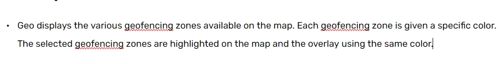

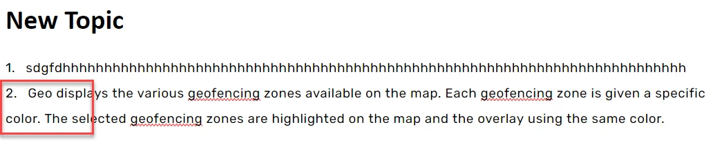

    Jun 1, 2021 1:19 PM UTC
    Hi Peter,
    The solution works fine for short texs. For bigger texts, this is how it is displayed:
    But this is not the way I want the list to be displayed:
    The 2nd line in the first point should align below the text and not the number.
    Is this possible with any settings?

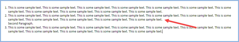

    Peter Grainge
    May 19, 2021 6:24 AM UTC
    @Divya V @Amebr
    Is Second Paragraph above what you are wanting? If so pressing Shift Enter at the end of a numbered paragraph gives you just that as both Stefan and I have pointed out and without going into the code. If your list items have more space below than this one, you may have press Shift Enter twice.
    If this is not what you are wanting, then please clarify.

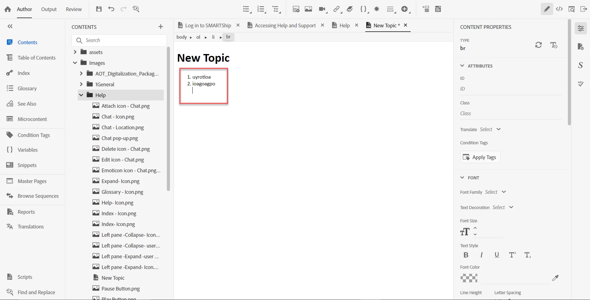

    Divya VAuthor
    May 17, 2021 3:55 PM UTC
    Hi Peter,
    Thank you so much for the solution. I tried it but this is not my requirement.
    I tried your solution and this is the result:
    But, I want the cursor aligned below the text:
    Can you please tell me how to achieve this?

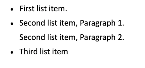

    May 17, 2021 4:04 PM UTC
    Difficult to understand what the problem is. Do you mean you want a second line in that list item? Is Shift-Return what you are looking for?
    Or do you want to have a list item two contain two individual paragraphs?
    If so, you would just need to add two paragraphs in a list item. Like this:
    <ul class="Disc">
      <li>First list item.</li>
      <li>
        <p>Second list item, Paragraph 1.</p>
        <p>Second list item, Paragraph 2.</p>
      </li>
      <li>Third list item</li>
    </ul>
