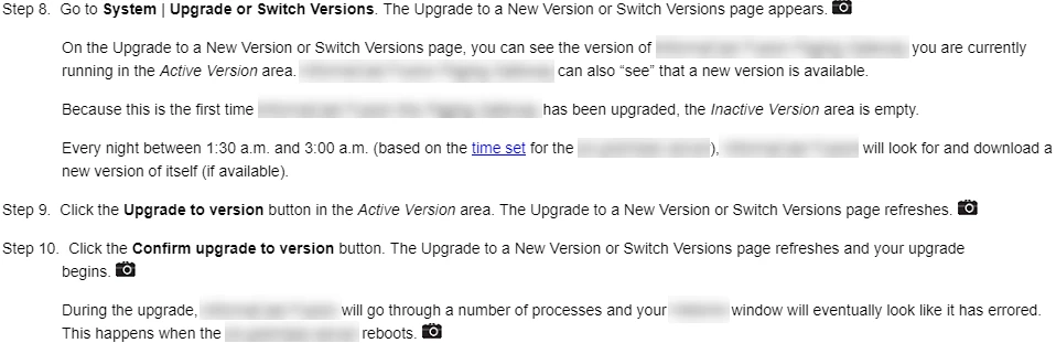

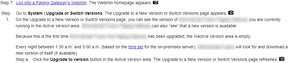

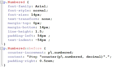

I'm using RH 2019.0.12. I have lots of numbered lists of steps with paragraphs of content that fall beneath them:
Everything aligns perfectly until the step numbering goes to double digits and then things fall out of alignment (shown in Step 10 above).

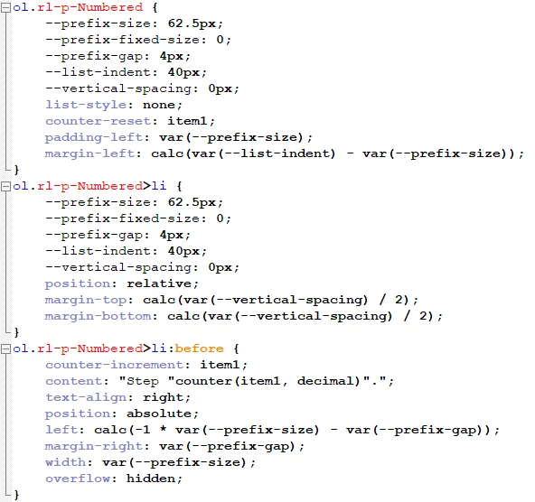

This is what my CSS looks like:
I suspect this has something to do with the padding-right value, but I'm unsure how to fix it. Everything I've tried seems to only affect the space between the decimal following the integer and the step's content, which just recreates the problem.
I did not have this problem in RH 2019 Classic. That CSS looks like:
I tried adding these values into my new CSS, but I'm pretty unfamiliar with this format and it did not give me the desired results (probably due to user error).
Is there a way to fix this alignment issue? Thank you.

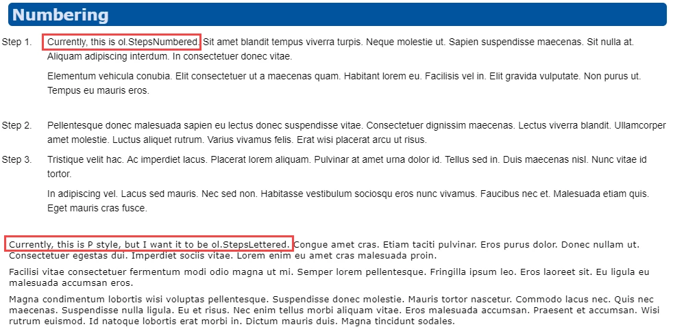

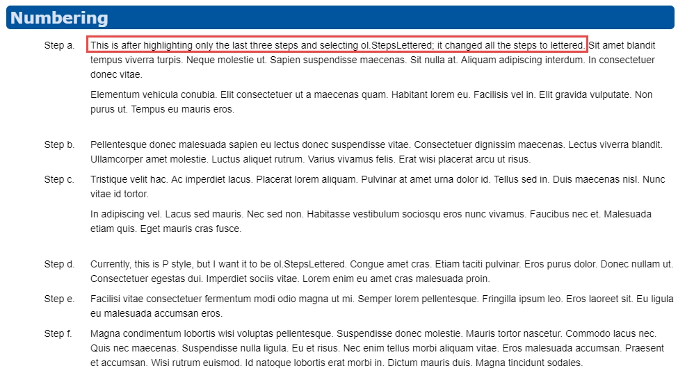

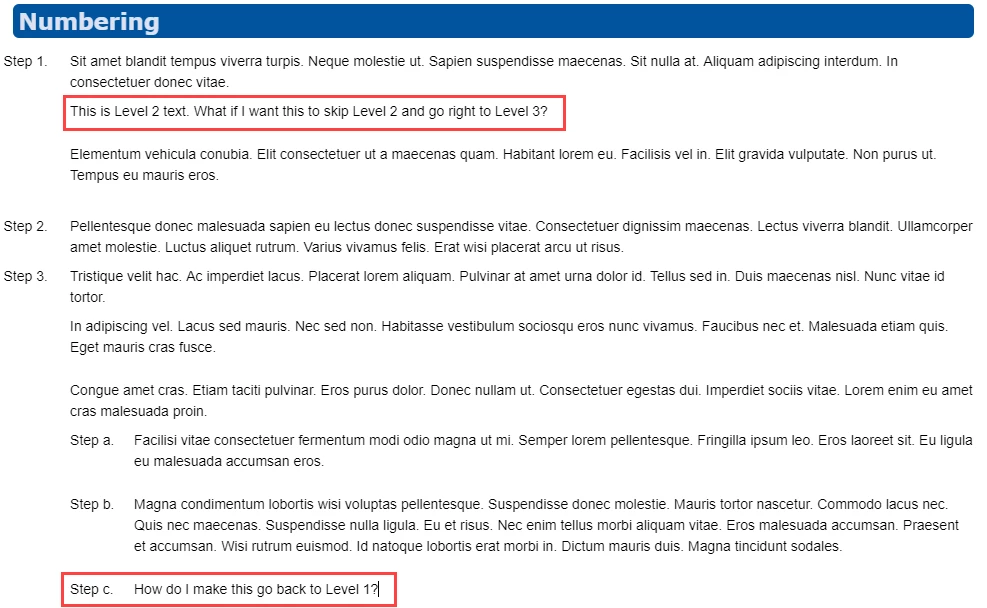

    Apr 7, 2020 1:09 PM UTC
    Sorry about the CSS. I was trying to be thorough so you could see how my multi-level lists were composed.
    While following your suggestion from March 27th (which did work in a new project for correctly aligning double digit numbers and subsequent un-numbered, indented paragraphs), I noticed that:
    • I couldn't seem to go up levels once I'd gone down them (which you solved with the Backspace suggestion)
    • I couldn't skip levels, which is rare, but not unprecedented. I sometimes also like to go from a numbered step to a bulleted list. Are you saying that I'd just insert a paragraph list style that would align correctly (probably two since one would align with single-digit numbering and the other with double digits)? If I wanted a bulleted list, would that be the same? It would allow that nesting without making both either numbered or bulleted?

      overflow: hidden;
      font-family: Arial;
      font-style: normal;
      text-transform: none;
      line-height: 1.5;
      margin-bottom: 14px;
      margin-right: var(--prefix-gap);
      font-size: 14px;
      font-weight: ;
    ol.StepsNumbered>li:before {
      counter-increment: item1;
      content: "Step "counter(item1, decimal)".";
      text-align: left;
      position: absolute;
      left: calc(-1 * var(--prefix-size) - var(--prefix-gap));
      width: var(--prefix-size);
      overflow: hidden;
      font-family: Arial;
      font-style: normal;
      line-height: 1.5;
      font-size: 14px;
      font-weight: ;
    p.StepNumbered::before {
      counter-increment: p\.stepnumbered;
      content: counter(p\.stepnumbered, decimal)".";
      padding-right: 0.5rem;

    I created three multi-level list styles, but none of them seem to fit my needs:
    • Steps
    • StepsNumbered
    • StepsLettered
    Steps was created following your suggestion for multi-level lists, but I can't seem to skip levels, i.e. go from a Level 1 to a Level 3, and I can't seem to go back up a level, i.e. from a Level 2 back to a Level 1. See the following picture for an example:
    Thinking I could get around this with two different lists, I created StepsNumbered and StepsLettered, both only two levels deeps with the idea that StepsLettered could follow StepsNumbered when necessary. This is an example of how StepsNumbered presents (with text highlighted in red):
    And this is what the source looks like:
    <body>
      <h1>Numbering</h1>
      <ol class="Steps">
        <li>Currently, this is ol.StepsNumbered. Sit amet blandit tempus viverra turpis. Neque molestie ut. Sapien suspendisse maecenas. Sit nulla at. Aliquam adipiscing interdum. In consectetuer donec vitae.
          <ol>
            <li>Elementum vehicula conubia. Elit consectetuer ut a maecenas quam. Habitant lorem eu. Facilisis vel in. Elit gravida vulputate. Non purus ut. Tempus eu mauris eros.</li>
          </ol>
        </li>
        <li>Pellentesque donec malesuada sapien eu lectus donec suspendisse vitae. Consectetuer dignissim maecenas. Lectus viverra blandit. Ullamcorper amet molestie. Luctus aliquet rutrum. Varius vivamus felis. Erat wisi placerat arcu ut risus.</li>
        <li>Tristique velit hac. Ac imperdiet lacus. Placerat lorem aliquam. Pulvinar at amet urna dolor id. Tellus sed in. Duis maecenas nisl. Nunc vitae id tortor.
          <ol>
            <li>In adipiscing vel. Lacus sed mauris. Nec sed non. Habitasse vestibulum sociosqu eros nunc vivamus. Faucibus nec et. Malesuada etiam quis. Eget mauris cras fusce.</li>
          </ol>
        </li>
      </ol>
      <p>Currently, this is P style, but I want it to be ol.StepsLettered. Congue amet cras. Etiam taciti pulvinar. Eros purus dolor. Donec nullam ut. Consectetuer egestas dui. Imperdiet sociis vitae.
        Lorem enim eu amet cras malesuada proin.</p>
      <p>Facilisi vitae consectetuer fermentum modi odio magna ut mi. Semper lorem pellentesque. Fringilla ipsum leo. Eros laoreet sit. Eu ligula eu malesuada accumsan eros.</p>
      <p>Magna condimentum lobortis wisi voluptas pellentesque. Suspendisse donec molestie. Mauris tortor nascetur. Commodo lacus nec. Quis nec maecenas. Suspendisse nulla ligula. Eu et risus. Nec enim tellus morbi aliquam vitae. Eros malesuada accumsan. Praesent
        et accumsan. Wisi rutrum euismod. Id natoque lobortis erat morbi in. Dictum mauris duis. Magna tincidunt sodales.</p>
    </body>
    Then, this picture is what happens when I apply StepsLettered to the last three paragraphs; it changes all of them to StepsLettered.
    <body>
      <h1>Numbering</h1>
      <ol class="StepsLettered">
        <li>This is after highighting only the last three steps and selecting ol.StepsLettered; it changed all the steps to lettered. Sit amet blandit tempus viverra turpis. Neque molestie ut. Sapien
          <ol>
          </ol>
        </li>
          <ol>
          </ol>
        </li>
        <li>Currently, this is P style, but I want it to be ol.StepsLettered. Congue amet cras. Etiam taciti pulvinar. Eros purus dolor. Donec nullam ut. Consectetuer egestas dui. Imperdiet sociis vitae. Lorem enim eu amet cras malesuada proin.</li>
        <li>Facilisi vitae consectetuer fermentum modi odio magna ut mi. Semper lorem pellentesque. Fringilla ipsum leo. Eros laoreet sit. Eu ligula eu malesuada accumsan eros.</li>
        <li>Magna condimentum lobortis wisi voluptas pellentesque. Suspendisse donec molestie. Mauris tortor nascetur. Commodo lacus nec. Quis nec maecenas. Suspendisse nulla ligula. Eu et risus. Nec enim tellus morbi aliquam vitae. Eros malesuada accumsan. Praesent
          et accumsan. Wisi rutrum euismod. Id natoque lobortis erat morbi in. Dictum mauris duis. Magna tincidunt sodales.</li>
      </ol>
    </body>
    Is there some trick I'm missing with using these lists? How can arrange these so that I can get the flexibility I need?
    Peter Grainge
    Mar 27, 2020 7:05 PM UTC

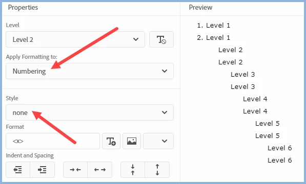

    Best to try it in a new project using the default.css until you get it working right. At the moment your old list styles could be interfering.
    In 2019 New UI the CSS3 and HTML5 are stricter and for your list it's best to set it up as a list style, not a paragraph with numbering.
    No you wouldn't combine the two. You set Level 2 numbering to None. See the image.
    Mar 30, 2020 2:19 PM UTC
    I understand about the default.css, and I think that's what I did. That's why I included the code; it didn't seem to be picking up the step numbering.
    Peter Grainge
    Mar 27, 2020 5:20 PM UTC
    This is in 2019 New UI, correct?
    Try this list in multi-level lists. For the paragraphs in between either use Shift Enter or more correctly edit the list style so that the second level has no numbering.
    Mar 27, 2020 6:16 PM UTC
    Yes, the new UI for 2019.
    The paragraphs in between the steps are currently a separate paragraph style:
    So, I'd basically combine these two paragraph styles into a multi-level list?
    Side note: switching between paragraph styles and list styles in a CSS in the RH UI seems to cause it to crash in multiple instances. So, that's fun.
    OK. Now my CSS looks like this:
    ol.Numbered>li {
      --prefix-size: 40px;
      overflow: hidden;
      font-family: Arial;
      font-style: normal;
      font-size: 14px;
      line-height: 1.5;
    However, that makes the text look like this (everything under Step 7 is the new format):
    So, my numbered steps are missing their digits. The paragraph below it (that I didn't assign numbering to in the CSS) is mysteriously using a number in the first paragraph, but not the second or third, and my lettered step seems to be mostly behaving itself (aside from a spacing issue I can't figure out).
    Also, this is my first time consciously using multi-level lists. Do I not choose this as a paragraph style? It's something I choose from the List Styles instead? How do I go back to Level 1 once I'm in Level 3?
