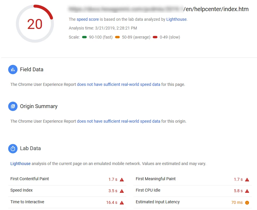

We are experiencing some slow speeds when loading in the merged help site from our online webserver. One user who has 20 Mbps download speeds, it took him about 11-12 seconds to load the site, and about 19 seconds before they get search results. (I'm sending out a survey in our company to get broader results, but I've seen slow loading and search speeds results from my computer as well and I have about 80 Mbps download speeds.)
For example, when I run the site through google's Page Insights (Desktop not Mobile-- Mobile is even slower), I get this:
Look at that "Time to Interactive" stat. Yikes! Anyone else see something similar on your large merged HTML5 sites?
I personally don't know what I can do on my end to optimize to increase speeds. This all seems to stem from how RH merges everything together with this particular layout.
Thoughts?

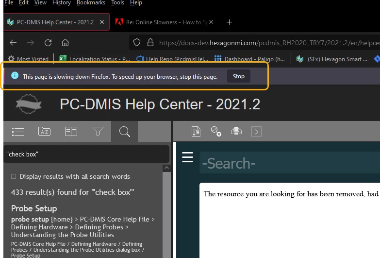

We have a larged merged help system. All told, we have ~28 MB of uncompressed search_db.js files (~6MB if we use the compressed .gz files). The largest is 12.06 MB and compressed it's 3.91 MB.
However, the ability to use these compressed files appears to be enabled already on our webserver, so I assume that something else must be causing these occassional "This page is slowing down Firefox..." messages.

I retested the searching in RH 2020 on our massive merged help system, and they've fixed the bug that was causing the search to take so long. It's quite snappy now. There is still an initial load whenever you first launch the help, but after that searches seem quite good.
Most of the time...
Sometimes (often?), it just hangs. And you have to click Stop and then refresh the entire page to get things working again.
If you're lucky, it continues to work. If not, you get the above message again.

Did you catch that recent discussion about configuring your web server to serve up the zipped form of results to browsers that request it? Enabling that seems to have improved performance rendering up results and pages.
