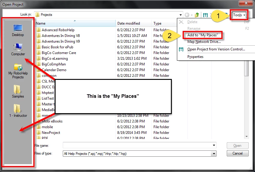

Oct 13, 2014 8:50 PM UTC
Hi there
You might try adding the folder to the "My Places".
In RoboHelp, click File > Open and browse to the folder. Then from the RoboHelp dialog, click the Tools drop-down as shown below and choose "Add to My Places"..
Once you have added it, you then should see an icon in that left panel you may click to just "go there".
Hopefully that will work the way you want... Rick

Willam van Weelden
Oct 22, 2014 1:45 PM UTC
If you look closely at the image of the open project dialog, you will notice an option 'Open project from version control' right in Rick's image. That may be what you're looking for.
