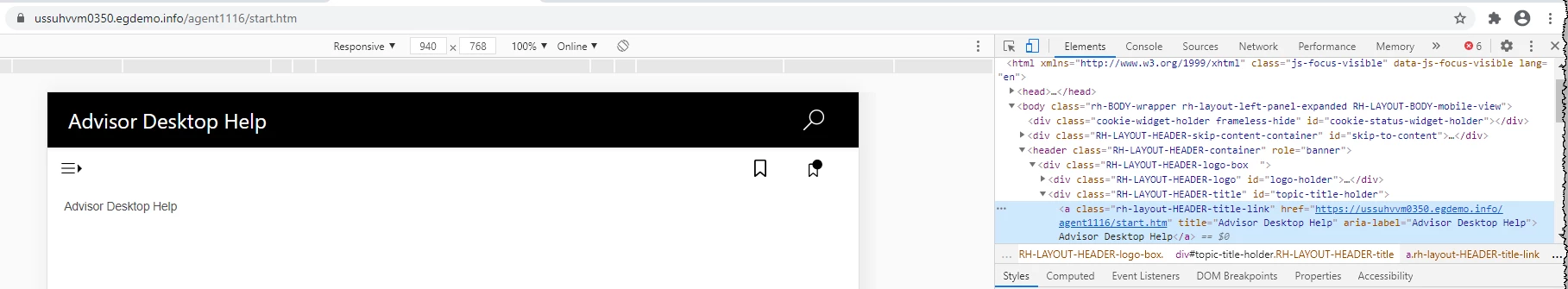

I've recently upgraded from RH 2019 to version 20. The online help we were generating used the skin's home page in the output. The name of the project would redirect to the home page upon clicking it as expected. This occured in both the home page view and topic view. Upon upgrading to version 20, the behavior has changed.
Now, when clicking the title link at the top of the help while viewing a Topic page, the body of the topic disappears and is replaced by the project title instead of redirecting. See the attached screenshots as an example of the different behavior as well as how the objects are identitied in the browser.
Through our own troubleshooting, we've noticed that this behavior occurs on our application when the homepage is "start.htm". We've been using this as our homepage name for a while, so we have a lot of legacy links to this page integrated into our application. However, when we generate the same set of help files with the same skin, and use a different homepage "index.htm" the behavior is back to what is expected.  To give you an idea of our environment that we're using, you can access a sample of our help with these links:

    Nov 17, 2020 5:24 PM UTC
    Thank you for your reply.
    We are using the Frameless output.
    • Start page = start.htm
    • Default Topic = welcome.htm
    • Skin home page = start.htm
    Attachment images below:
