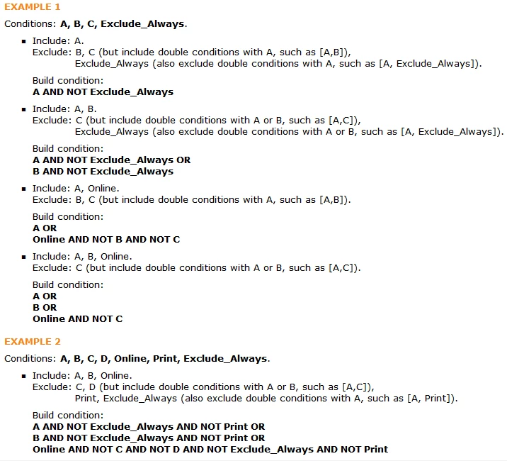

With overlapping tags, the formulas become a bit tricky, but it can be done. When I was using RH9 I once made an overview of complex conditions (see below), most of it will probably still apply today. It probably works fine with compiled output.
However, I tried recently using conditions for dynamic selection (such as product1, product2, sysadmin, enduser) but that opens a whole can of worms when you try to apply dynamic conditions. The search finds topics that if you click on them say "cannot show this topic with the selected conditions" (well, then don't find them either, yeah?) and all other kinds of weird stuff happening. Especially when entire topics are excluded dynamically, the TOC still shows them. So you need to exclude the topics as topics, but in the TOC too. Just too much hassle. So I have more or less given up on dynamic conditions. Nice feature in theory, but not usable in practice. At least not IME. YMMV.
Anyway, the examples of complex conditions use A, B, C and D as product conditions, Print and Online as output conditions, and Always_Exclude as author condition, which means these included text that was meant as comment for the author only (such as "check if this statement is correct").

It looks like SM is always included so no need to tag it. Then tag content Admin or Op. When generating for SM and Op, the expression would be Not Admin.

Are you saying this worked before? I would be surprised if that did work because in part of the expression where the tags overlap you are telling RoboHelp not to include something and then telling it to include it. A bit confusing.
Generally expressions work best when you just use exclude. The rest gets included. Perhaps rethink the content and apply tags so that one or the other is excluded.
