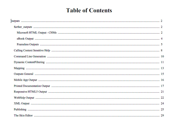

    Hi Peter,
    Thank you! Issue 2 refers to the folder names that can be seen in images 1 and 2 ("outputs" and "further outputs"). These are not displayed in the bookmark section of the PDF, but should be. Folders are used as structuring elements either directly in the project or just in the TOC of the project, so they should also be shown as such in the bookmark section, shouldn't they?
    The other thing besides the code being wrong that does not work is the consideration of header levels in the bookmark section (the issue that JC2 reported initially. Header levels are only considered within the same topic. If you are having a topic with header 2, it is displayed on the same level as the "parent" topic with header 1.
    I hope I could clarify my post.
    Best regards
    Karin

    Hi there,
    I just checked into these issues again with update 9 and a fresh sample project that I adjusted slightly. This is what I found:
    1. the bookmark code is still wrong (saying <h1><a id="bookmarkname"></a>First Topic</h1>)
    2. Folder names are still not shown in the PDF bookmark section
    2.a) they are shown correctly in the PDF's TOC
    3. Headers with bookmarks are partially displayed, but usually on a wrong level in the PDF bookmark section. So, something seems to have changed in the behavior here, but it is still wrong.

    I created some screenshots of how it is displayed:
    Image 1
    Image 2
    Image 3
