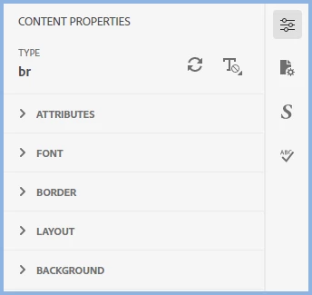

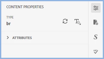

    With Do Not Allow selected, when I click in a page layout, the Content Properties will be as below.
    Deselect the option and they extra options appear.
    First of all, is that what you see in the project that started this thread?
    Perhaps you could select the option when working on topics and deselect it to work on templates? As far as I can see, the option does not remove any inline formatting, it simply stops you applying further inline formatting. In one page layout with the setting removed I applied a colour to some text. Then I selected the setting again and the font colour was still applied. When I applied Do Not Allow again, the settings came back and showed the colour in the properties.

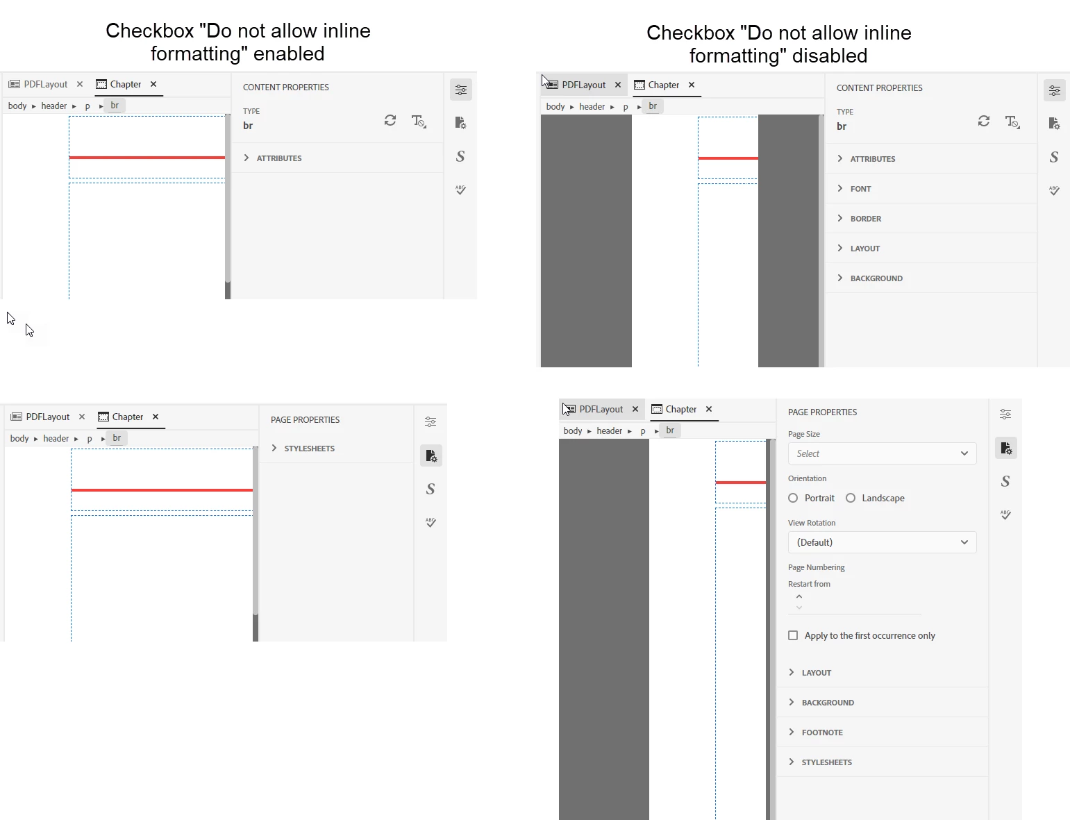

    I can confirm the behavior you described. In fact, it not only changes the content properties but also affects the page properties (see image below).
    Additionally, I can confirm that the checkbox only impacts the UI and the displayed options there; it does not affect existing inline formatting nor does it prevent adding inline formatting via the HTML editor.
