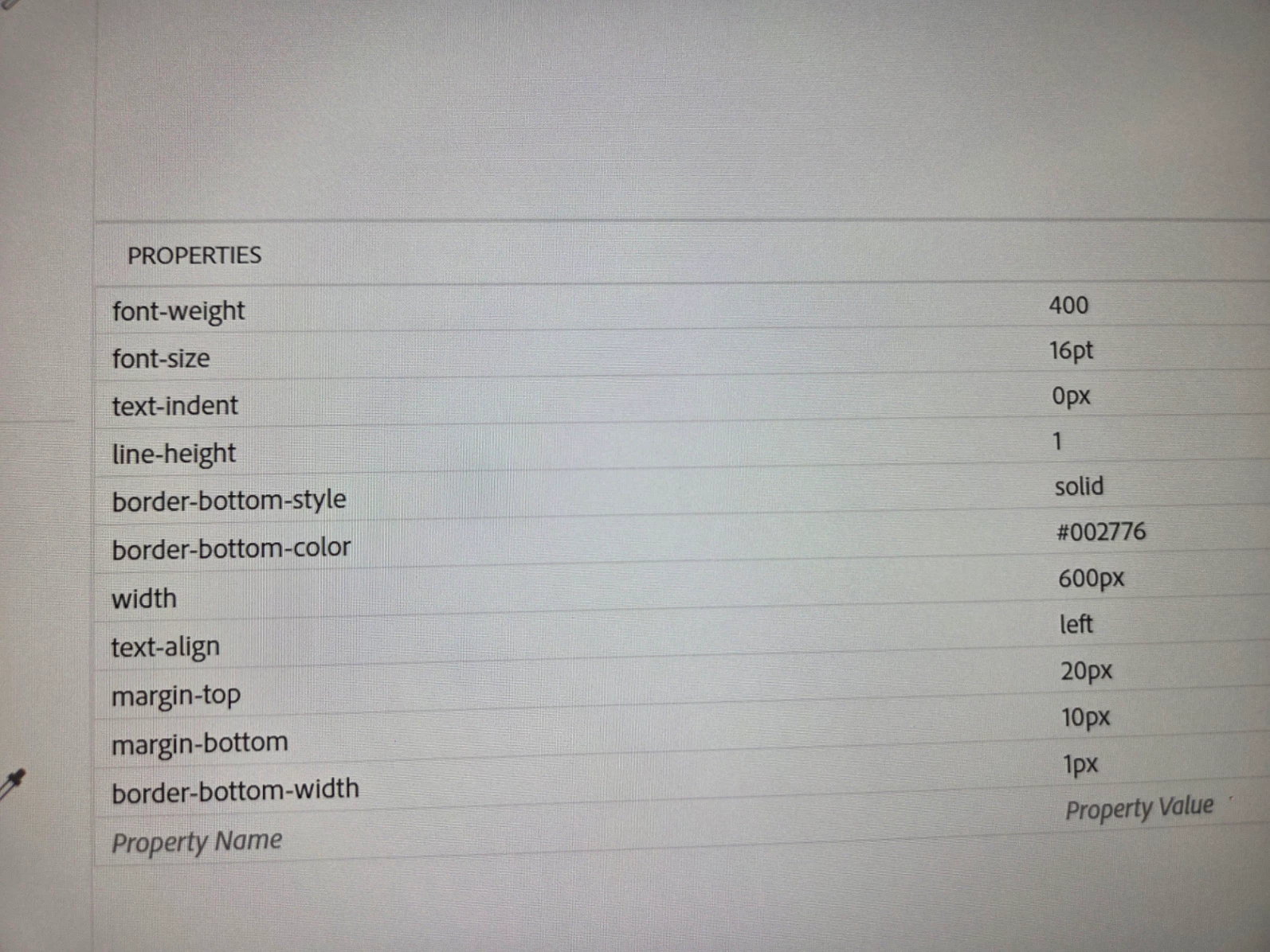

    But, like I said I do need to move on.  In the meantime, I do have what I hope is a quick/easy question for you. I notice on your site there are a number of h2 topics where you build a border around the text that extends the width of the page. For the life of me, I can not get the border/background to reach to container extents. I've tried setting the width to 100% and I've tried a fixed setting of 1000px in an effort to get it to expand. But, it still sizes to the text. I know I can cheat and build a 1 column/1 line table - but that's messy and extra html.

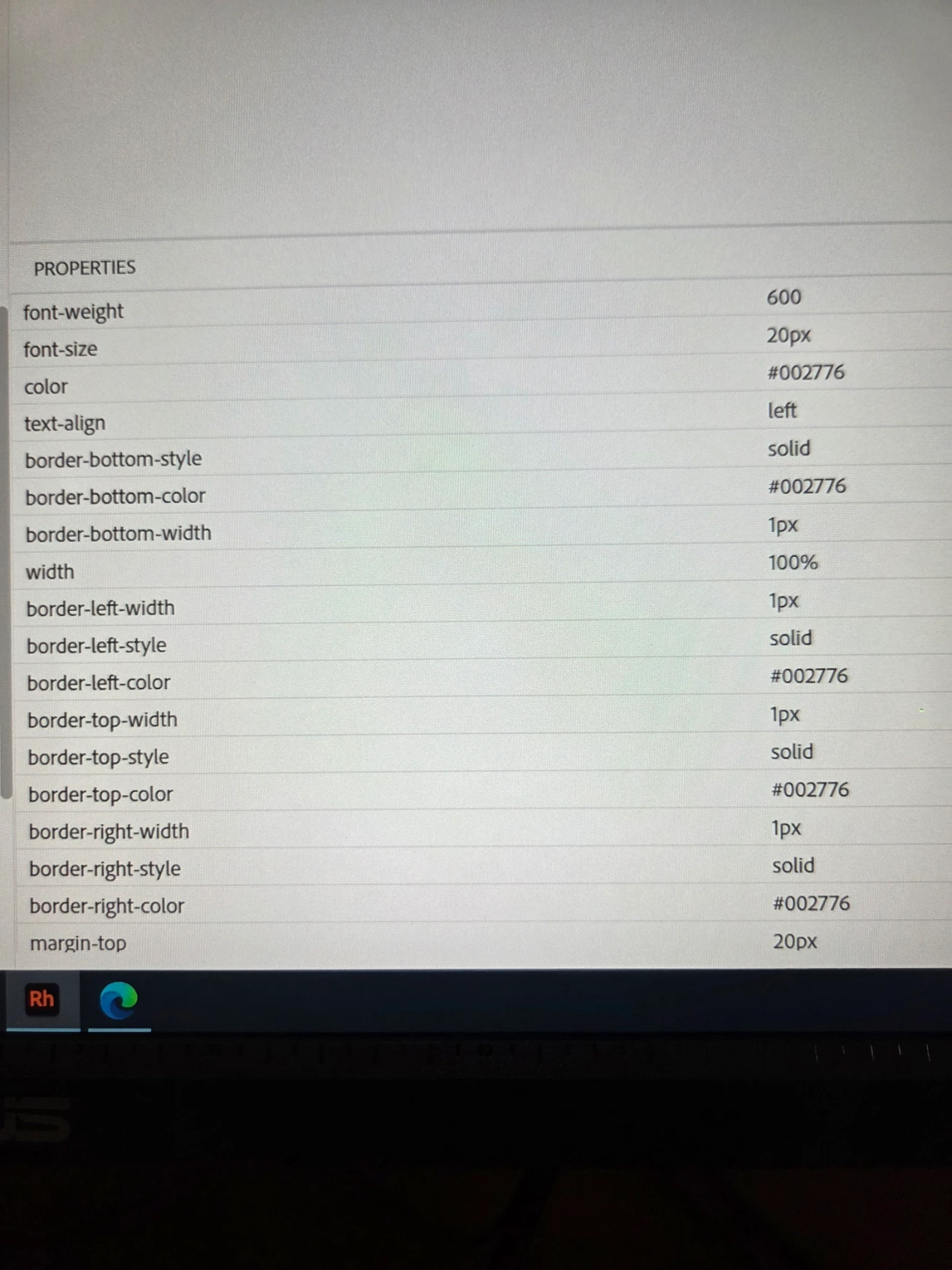

    Hmmm.... okay. So copying the file into the new project still exhibits the problem. Amending the h2-blue to h2 resolves the problem.  What in this .css setting could be the cause of the problem -- or is the .css file simply corrupt and deleting and recreating the .css would resolve it.  I've attached a copy of the settings for that tag. I apologize it is a photo, but I work for a government agency and cannot send image files outside of the bldg (even if they are as inocuous as a .css entry).
    First, thank you for all your help so far... we are definitely narrowing it down. But, what is your suggestion to fix the issue?

    When you apply H2 to a paragraph, RoboHelp will simply write it as H2. All the extra stuff is inline styling that you have applied. Why are you not defining H2 in the CSS to get what you want rather than selecting the paragraph and applying the styling inline?
