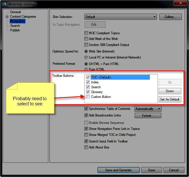

I tried the snippet instructions but I'm running in an issue of the button not showing in the actual webhelp.
I've set it up in the skin editor, and it shows on the editor's preview pop-up, but when I generate the actual help, it's not there.
Captiv8r
August 23, 2011
Hello again
Remember, when you add a custom button you also have to enable it in the SSL recipe.
Look at the options where you specify buttons. Likely it's not selected.
