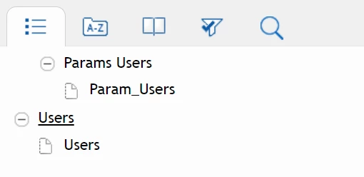

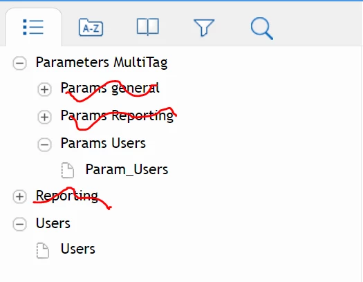

    Jul 18, 2022 1:07 PM UTC
    Thanks for your help, Peter. I will send you a test project to look at.

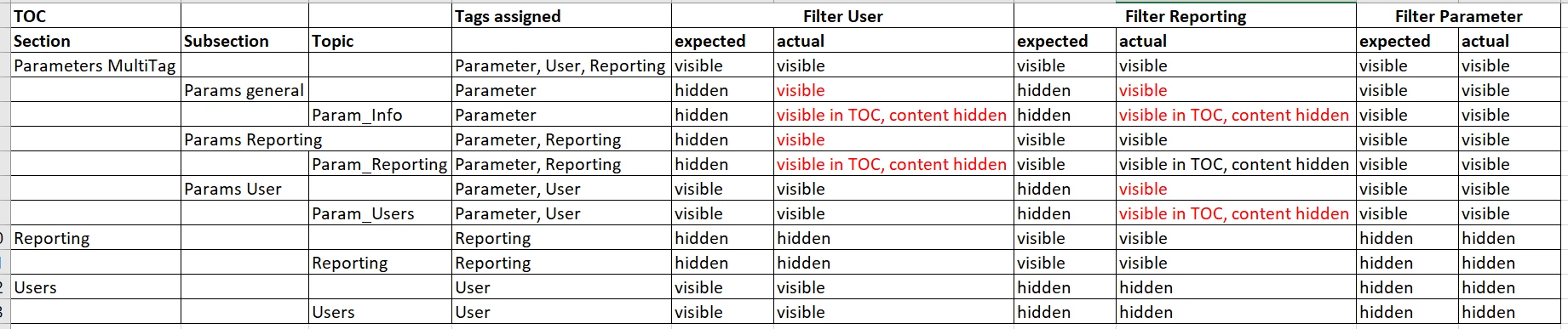

    I tried to create a table that further explains what I want to achieve and what I get:
    Also, when I do not apply tags to the sections in the TOC, what I said above is not correct. In this case, the topics are filtered correctly, but the sections are not displayed (correctly). In my test project, this looks as follows:
    It should look like this:
    In my actual project, it causes that the parameter topics can only be found using the search, they are not displayed in the TOC at all (because their sections / subsections are not displayed).
    Peter Grainge
    Jul 18, 2022 7:53 AM UTC
    Sorry to say Dynamic Content Filtering is not what it was. First of all in the new UI we lost the ability to apply expressions to filters. Then in Update 4 we could no longer apply a tag to both a topic and content. I don't think that has been fixed and I'm not sure if there was a reason for that change or if it was deliberate for some reason.
    If you create a simple project with just the minimum number of topics to test this, I will take a look at it but I'm not hopeful.
    In the first topic please explain in a table what you expect to see when each filter is applied and what you do see.
    Great if I can do something but if not, I will take this up with Adobe again.
