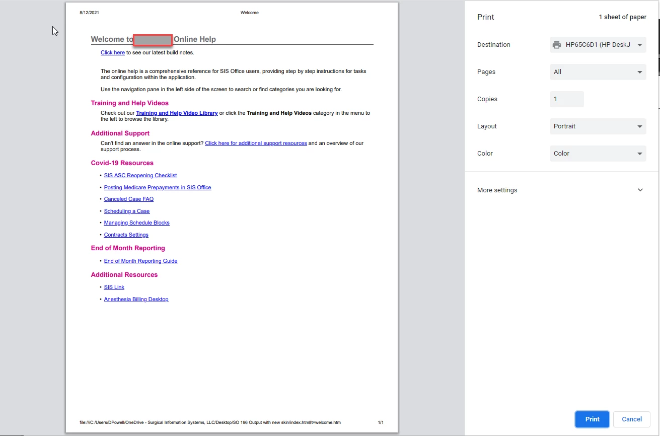

Peter Grainge
Aug 12, 2021 6:55 PM UTC
The blue button is preferred but no need to repost if you do use the other one.
My understanding is you have clicked the print button in the skin and that has opened the browser's print dialog. Once that comes up if you cannot cancel it is an issue with the browser, not RoboHelp.
Please correct if that is not the case and include a screenshot of the dialog. Use the photo icon to add the screenshot.

Aug 12, 2021 6:42 PM UTC
(sorry for the double-post, but i used the wrong Reply button)
We are having a similar issue where it can take two or more attempts at clicking Cancel on the print dialog to close it. We're not having the issue of printing two copies. Here are the details:
  • The issue occurs in Responsive HTML5 output created in and generated with RH 2019.0.14.
  • It occurs in both Chrome and Edge.
  • It occurs in a random sample of topics.
  • It DOES NOT occur in a Responsive HTML5 output (of another project) created in and generated with RH 2019 Classic.(both projects are hosted on Azure).
  • I imported the skin from the Classic project that doesn't have the issue into the project in question, and the issue still occurred. So it doesn't seem to be the skin.
I appreciate any ideas or trouble-shooting suggestions. Thanks!
