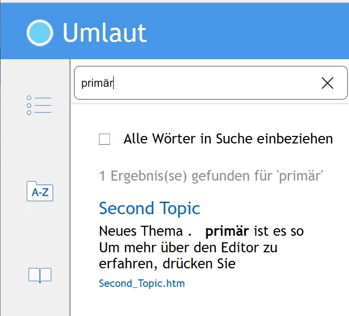

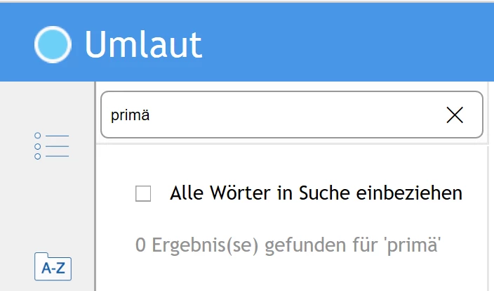

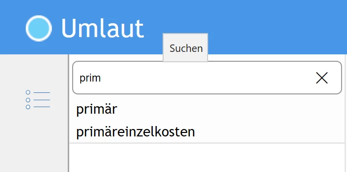

In my output, I have several topics containing the word "Primäreinzelkosten". If I search for "primär", I only get results containing exactly the word "primär", but not the "primäreinzelkosten". If I search for "primä", I get no results at all. If I search for "prim", I get all topics containing "primär", "primäreinzelkosten" and "primrose" or whatever. So the substring search seems to have a problem with the "ä". The substring search works as expected for example when searching for topics containing the word "Kostenblock". They are found whether I search for "koste", "kosten", or "kostenb".
My project language is set to German, my output language is also set to German. I tried outputs with the following Encoding settings: Default Encoding, Westeurope(ISO), UTF-16, UTF-8 without BOM. I also tried the outputs in different browsers (Chrome, Edge, Firefox). No matter what, I do not get any results when searching for "primä".

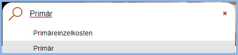

    Hi Peter,
    I just ran the test, same issue with a brand new project and default skin Azure Blue:
    Peter Grainge
    Apr 30, 2020 2:18 PM UTC
    I just tried putting both the words below in separate topics and generated with both a frameless and a responsive skin. Worked both times.
    Try in a test project and see what you get.
