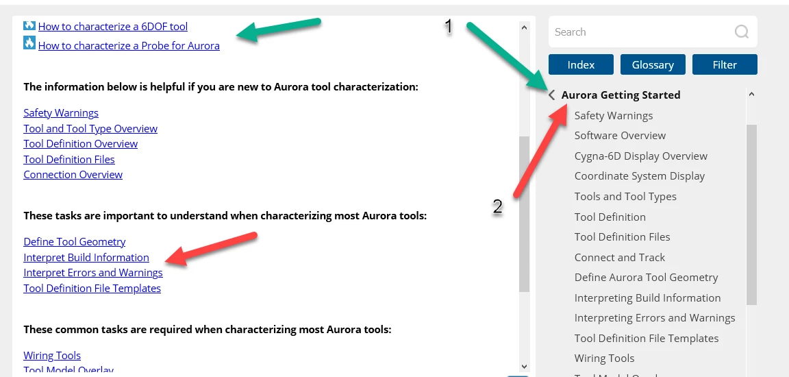

    I have manually created a page with links to topics...
    In screenshot, item 1, you go to the landing page and the toc is correct.
    But...when you click the link, item 2 (red arrows), you are taken out of this book and into the first book where that topic appears (the book for the other product's onboarding sequence).
