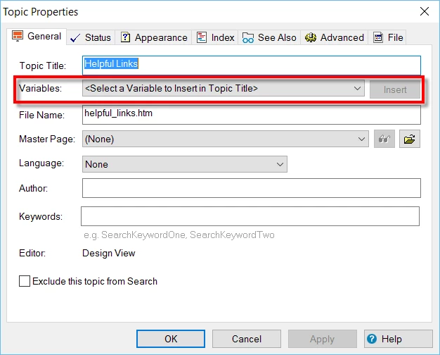

    In the 2015 Release version, my Topic Properties dialog looks like this:

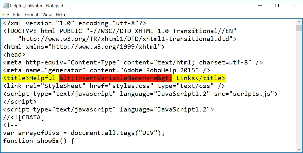

    I believe version 11 may have introduced the ability to have a variable in the Topic Title. If your version is earlier and doesn't seem to offer up a way via the dialog to deal with this, I'm wondering if you could fudge it by manipulating the code manually. For example, I see that when I use a variable in a Topic Title, I end up with this:
    So I'm wondering if you could just add in the bit that reads:
    <InsertVariableNameHere>
    Of course, you would want to replace the text InsertVariableNameHere with the actual name of your variable.
    It may fail miserably because the RoboHelp generation process doesn't know how to deal with it. But it might actually work! You won't know until you try.
    And even if it fails, I may be able to offer another approach that will allow you to overcome the issue.
